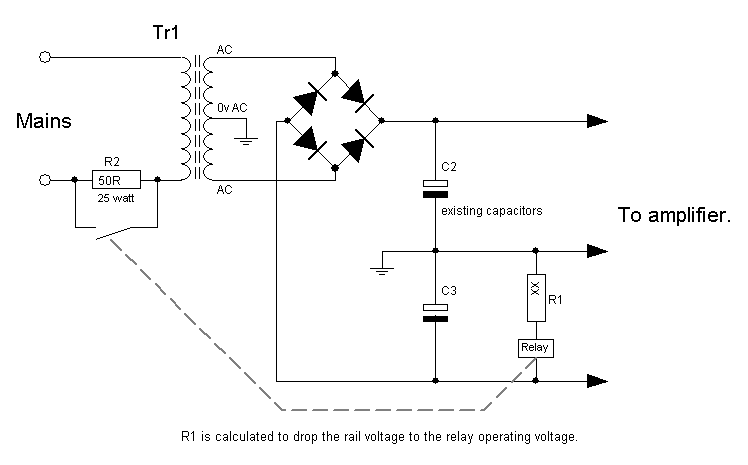

And the simplest relay soft start. The relay "waits" until sufficient charge has built across the main power supply capacitors. It then closes shorting out the primary series resistor.
This circuit must be used in conjuction with a speaker delay circuit that closes after the soft start relay. Otherwise the amp may be drawing too much current at turn-on. If this happens the soft start relay will never close and the primary connected resistor burns out. This could be also be viewed as cheap insurance should something be wrong with an amp module.
Cheers

The trouble with NTC thermistors is that they don't get hot enough to reach a low resistance unless your amp is pulling a significant amount of current.
They don't work on class A/B or class B amplifiers. If you've got a class A amp with a high quiescent current , then NTC thermistors are the cheap and easy option.
Edit:
As stated earlier though, if you turn your amp off and then straight back on again, the NTC will still be hot and you lose the inrush limit. You'd have to wait at least 5 minutes for the NTC to cool before switching back on. A relay is still the best option all round.
For class A/B and class B amps you really need a relay switched power resistor. Here's a nice simple circuit that does the trick:
At power on, the 7.5 ohm 10W resistor is in the transformer primary and limits the maximum current that can flow. As soon as the filter caps start to charge, the 1000uF cap across the relay starts to charge via the 1.1k resistor. Once the relay sees enough voltage ~19V, it pulls in, switching the resistor out of circuit. The whole process takes just about a second, which is plenty enough time for everything to settle. My NAP135 clones will blow 3 Amp mains fuses at every switch on without these. I've also added a second relay using a similar circuit fed from the other supply rail to the speaker outputs to get round the switch on thump. My amps don't have the Naim protection circuits, but the amps are well protected by the regulators anyway. I used a 2200uF cap here to provide a longer delay.
If your supply rails are at a different voltage, then you'll need to use a different value for the 1.1k resistor (the relay needs roughly 40 mA) and then recalculate the cap value to maintain the time constant.

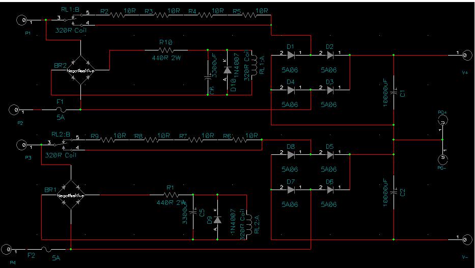

This is the design I've made so far (before coming to diyaudio).
The advantage is that you don't need another x-former or windings. The reason that theres two relays is because I had two 12v coil 6A relays with one set of contacts only.
The disadvantage.... please tell me.
I'm far from finishing the design so any comments are MOST welcome.

Hi Wynand
Your circuit seems to be intended to be connected to the transformers secondary winding, and seems to limit the charge currents to the capacitors.
All soft start circuits that I have seen limit the current flow to the transformer primary i.e, the mains side. This is done to limit both the inrush of the transformer as well as the DC supply. Transformers can have huge inrush currents (particularly toroids) because they are effectively a short circuit until the magnetic field is established.
Still you are limiting some of the inrush and that could be enough to stop your fuses blowing.

Hi Wy,
that is difficult to read!
the limiting resistors are in the secondary feed to the caps.
This reduces the peak current charging the caps, there is nothing wrong with this philosophy, it is shown in the data sheets for NTCs.
However it does NOTHING to help with current surge in a large toroid when first switching on.
To achieve soft start to the toroid you need the resistor limiters in the primary of the transformer.
BTW the 50r resistors in the secondary circuit are far too big. All five resistors could be put in parallel giving 2r and limiting the charging current to the caps. Or four Rs in series // giving 10r for a lower charge current.
How long is your relay RC time constant? What will the running current be through the relay coil? Will it run hot?
If you move your limiter to the primary side then 50r is about right for 240Vac. 110Vac needs a lower value, try about 20r to 30r.
Edit,
20mF is nothing special. That is not the problem, If you had >56mF then charging will be more of a problem.
