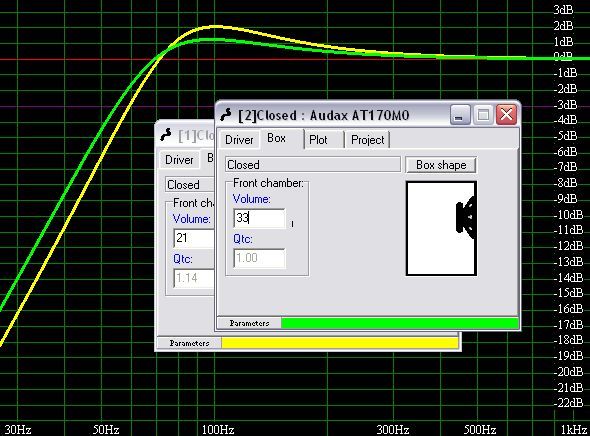

Audax do not usually produce drivers with poor specs.
Your problem is not a huge Vas - its a high Qts.
Simply put I don't believe the specs, I think Qts is lower.
Fs and SPL sound typical of a paper Audax driver.
But with Vas of 36L (= lightweight cone when Fs =48hz)
I'd expect Qts to be around ~ 0.3.
Your experiments with a sealed box also suggest this.
WinISD suggests BL = 4.3 = a very wimpy magnet.
If the magnet looks fairly reasonable i'd say specs are wrong.
If they are right it should boom away in any box around 0.75cuft.
Not much point in Q less 1.
🙂/sreten.

Sure, Qtc of .707 is a nice goal, but how do you get there with a woofer with a Qts of .69? An infinite/open baffle would be one way, but this driver doesn't have the Xmax to do that effectively. So the only option left is a Qtc of .9-1.0 or so.

As I said in an earlier post there not much point going lower than Q=~1.
This occurs when Vbox ~= Vas, making the box bigger than Vas
will just mean Vas will dominate and the box will have less and
less effect as its gets bigger.
Most speakers have light stuffing nowadays (BAF/Poyfill), but this
is definetely the case where you should go for maximum stuffing.
I'd go for rockwool (stuff that comes in blocks to go in wall cavities).
This would also work for the resistive port as outlined by p10.
So a 30L to 35L box, stuffed to be ~ 25% bigger + resistive port.
🙂/sreten.
