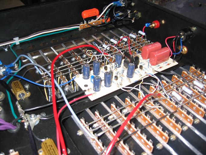

Here are two newly completed 100 watt Aleph-X monoblocks. The project started back when the Aleph-X thread was in full swing. Most of the time has been spent gathering parts and getting sidetracked on other things. The actual building took place over the past 4 months.

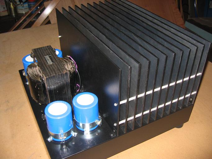

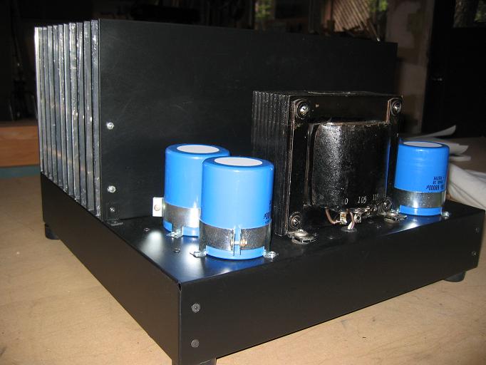

The units are built on 17" x 17" x 3" inch Bud chassis and weigh 64lbs each. The heatsinks are .187 5052 aluminum sheet stock from onlinemetals.com that has been sliced and diced on a table saw into 17" x 8" plates each of which takes two IRFP240's. 5052 is the cheapest stuff they sell. The center ten plates (of 12) hold the 20 output transistors. The front and rear plates are not part of the heatsink but are present to insure that the center ten plates have an approximately equal thermal environment in terms of convection and radiation patterns. These two plates are .125" thick (because I had some of this on hand). Only the front of the front plate, the rear of the rear plate and all the edges are painted. All other heat sink surfaces are left natural. The plates are connected with 6-32 threaded rod from the local hardware store and the separators are 3/4" unthreaded standoffs out of the Digikey catalog. The 240's all run within a degree or two of each other. The bottom of amp is open and there are two large rectangular cutouts in the chassis under the power transistors to allow air to flow up into the heatsink. The heatsink assembly alone weighs over 30 lbs.
I admit that this all yields a very ugly looking amplifier. However, you end up with a result that performs as well as any other with minimal time and money spent.
The amplifiers are painted with black satin enamel primarily because Mrs. GL put her foot down regarding the use (again) of natural aluminum amplifiers in the listening room. Search for the "DIY heatsink" thread to see an example of this type of construction in "natural".
Virtually everything in the amps came from readily available sources (in the US) like Mouser, Digikey, onlinemetals, and Madisound. The PS caps are stubbies from the BGMicro sale at $3.00 each. The transformers are Signal 88-8's out of the junk box. Various bits and pieces like capacitor clamps, connectors, and miscellaneous hardware came from the junk box too.

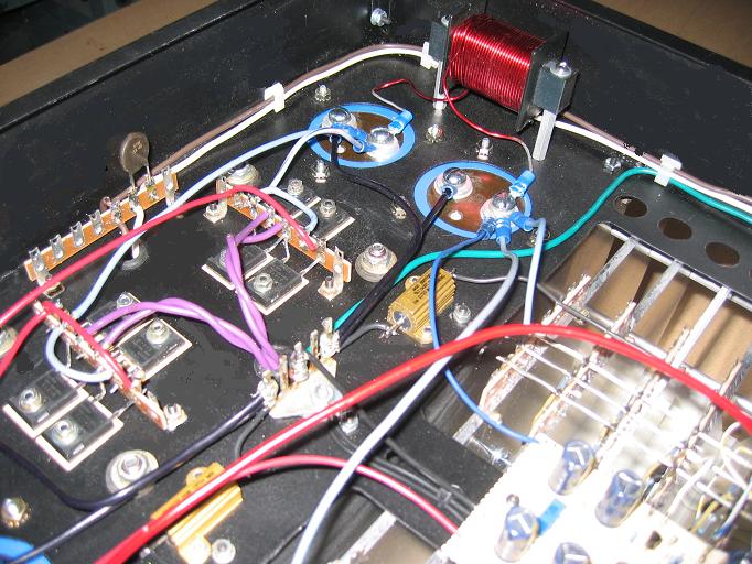

Construction of the circuitry is symmetrical - both on the perf board as well as for the output section wiring.
The original plan was to build 150-160 watt versions using 24 output devices. The total heat load for the room would have been 1100-1200 watts. For that much heat budget I figured I could build four 100 watt units, then biamp, and have 400 watts of effective output power available for each speaker.
With 500ma of bias per output device and with the amp on it's side on the bench (a thermally suboptimal orientation), the heatsinks rise to a temperature 21C above ambient measured at the edge of the plates directly above the transistors. This was better than I had hoped for. V1 and V3 have since been replaced with fixed resistors and the bias increased to 540ma per device (115W @ 8 ohms). After the amps are running right side up with their feet on so that convection cooling is optimized, I will see how things go and maybe turn the bias up to 600ma. Unfortunately that increases the total amount of heat being dumped into the room. Class A - you've gotta love it.
Relative offset is less than 50mv right from turn-on. It typically settles to less than 3mV on one amp and less than 10mV on the other. Absolute offset, however, starts at 3v and settles to less than 1.5v within ten seconds. It then begins a slow decline to somewhere less than .7V after an hour - but its still dropping very slowly. It feels like I'm going to have to leave the amps on for several days to find the ultimate best point for this adjustment.
I have listened to the amps on and off what with adjustments for maybe 4 hours and only 2 hours at full operating temp with the CCS's adjusted to 50%. At this point I can only say that they sound just wonderful. The sound is pure and clean up to very high levels. They resolve low level detail and create three dimensional spaces better than anything I've heard. There is no hum or noise even with my ear next to the loudspeaker. A fantastic amplifier. Do I sound jazzed? Well, I am.

1) Rail voltages were increased to about 26 - 27V. The CLC type supply uses 68KuF/50V - 1mH - 68KuF/50V filters on each rail. The inductors are Madisound Sledgehammers. Yes they probably are saturating - but they look so cool. There is a great deal of discussion on the Aleph-X thread about sagging transformer secondary voltages under heavy load. I did not experience this. The transformers have a slight soft buzz that's only audible up close.
2) The output device complement was changed to 20 IRFP240's per monoblock or 5 transistors per quadrant and bias was initially set to .5 amps per transistor for a total of 5 amps. These were matched to within .01V in sets of 10.
3) Output source resistors were set to 1 ohm @ 1% to help equalize the dissipation on each output transistor because of the separate heatsink plates. They are 2W Ohmite NI wirewound types chosen because they were one of the better and less expensive units in the catalogs.
4) The CCS sense resistors R2, R3, R42, and R43 were changed to .47 ohms because I had a pile of them. Extra resistors r50, R51, R52, R53, R54, and R55 were added.

14) The rectifier bridges are individual IXYS FRED type soft recovery diodes. There are two bridges in each amp for the two center tapped transformer secondary windings. The outputs of the bridges are paralleled at the first filter cap. This seems to work fine.
Whenever possible individual ground wires were run to a single star ground. There are three ground connections to the PCB: one to each group of input (+ and -) related grounds and a third which collects the power supply connections including the CCS. The RCA jack is insulated from the chassis and its ground pin is connected to pin 3 of the XLR and then pin 3 of the XLR has a separate wire back to the star ground. The star ground is connected to a frame ground (near the IEC inlet) through a CL60. The IEC inlet ground is connected to the frame ground.

Thank you. I've used this method for years. With 5A of bias the heatsink temperature rise over ambient is 21C. When you're working in a garage that has an ambient of 7C these make great hand warmers. In the listening room and with 5.4A of bias the sinks are quite warm but not hot or even uncomfortable.

Hi Graeme. That is impressive work you did on the A-X🙂 Studying the pics, reveals the work of a true craftsman😎 Very nice built indeed. You just gotta love the "tube-like" impression.
Nice way of heatsinking.
Also the measured performance is pretty nice. The minimal DC offset is very good. Congrats🙂

Yes this is just simple point-to point wiring on the perf board. The board material is a better grade of phenolic and is made by Vero. I don't have a part number. It came out of the junk box. If I had purchased the material I would have bought one of their FR4 versions instead. It's better material. Mouser and Digikey both carry the Vero products I believe. The layout of the parts on the perf board was my own.
