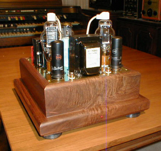

Attached is a picture of the layup so far. The top plate is polished 3/32" yellow brass under the protective paper. Wood is oiled black walnut.

The case was made with the largest pieces of walnut I could salvage. Initially I wanted an 11"x17" chassis. This one is just 9"x10". The circuit is dictated by the amount of wood I had and available parts. No room for two more tube sockets I'm afraid. A pair of IT's could be fit underneath if I make room by getting rid of plate chokes for the ouptut stage. To do this I'll need to buy SE output xfmers for topside. That will cost money. So will IT's. Not an option just now.

Took me all day but I now have the brass top plate machined and overcoated with clear lacquer. A second coat of linseed oil is drying on the base and tomorrow I can start assembly.
I changed formation from the flying Vee (the tube location pattern first considered) and moved the electrolytic caps in between the rectifier and the output bottles. This should reduce the possibility of induced rectifier noise by more distance and grounded obstacles, and gives me more room to accomodate other output xfmers later on just in case.
I will need to make sheet metal sub-chassis for underneath. I want to be able to lift the entire circuit out of the case by the top plate and not have guts screwed to the insides of the wood. There is just no room to work in there that way. This thing is going to be well packed.

Thanx muchly for the compliments Guys!

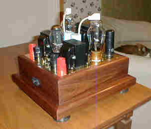

As of tonight I have it assembled and all finished on the exterior. I still need to wire it and stuff the insides, but it does look purty. The front is a beautiful chunk of tiger walnut that folows you as you change the angle of view. See where I put the pilot LED? Too bad this rare chunk had a crack in it but it was such an amazing piece that I just had to use it. Some of the most amazing grain pattern hardwoods are quite sensitive to drying fractures. The only filler I had on hand is mahogany and shows up. I can address this later. You probably wouldn't have noticed it if I hadn't said anything right? 😉
Here are some pics. Like my sexy miniature speaker binding posts?

Here is how I built this amp.

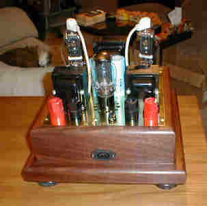

Time to share the build sequence photos and construction details of my amp with the group.
As I had explained I was after good looks on this one and that forced me to use a box, the largest I could make with available walnut mill scraps from my firewood pile, which were on the small side. Conspiring towards a space problem was the fact that I did not have real SE output iron, so in addition to a pair of Hammond 1615, 15 watt, 5k to 4-8-16 P-P output xfmers I had to shoehorn in two foil and oil motor run caps the size of a cans of soup and also two plate chokes (vertical output xfmers hand selected for balanced L and salvaged from late 1940's vintage RCA television receiver chassis). This project was ALL about available parts and creativity!
The massive (and sexy don't you think?) 5 way speaker terminals are impedance selected on any of the 3 output transformer taps with a ceramic rotary switch with parallelled silver plated segments driven by a user adjustable knob next to the main power toggle switch located between the speaker terminals at the top rear of the chassis. Best match to the speaker system may be obtained by adjustment. Mismatch is much more damaging to the performance when only 3 watts are available. The gold plated RCA input jacks and adjoining screwdriver adjustment input pots are at the front of the chassis top between the input tubes and the power xfmer.
I also had to find room for two rather large Hammond 937 interstage xfmers in order to drive the 809's properly in A2. BTW I have G1's biased at ~+9 VDC and with a plate cathode voltage of 390 VDC I am running ~48 mA in each output tube and dissipating about 18.5 watts. The PD is 25 watts for these tubes.
Also hidden inside are the main PS choke (7 Hy's@140 mA), and a custom wound dual filament winding power xfmer for the two DC supplies for the 1619 heaters. The two 809 heaters are in parallel sharing the same DC filament supply which uses the 6.3 volt winding existant on the main power xfmer. I just did NOT have room for anoither filament xfmer as to separate the 809 heater supplies and successfully worked the schematic to accomodate this handicap.
DC for the red LED pilot iis obtained from the positive DC 809 grid bias supply employing a 3 watt, 8.2 volt xener circuit and the LED in series.
A humble amount of DC power for the computer PSU salvaged 4" cooling fan is also pulled from a voltage divider chain in the amplifier circuitry. The fan is mounted externallly under the amplifier's bottom plate, hence the need for tall footers. Might as well run the fan instead of heating a power R with this limited energy supply.
I had to be clever about power sources as my power xfmer was sized marginally (using available parts). I get B+ power for the driver 1619's by stacking them in series under the 809's. That way the 625 volt B+ at 120 mA available has enough power to run both 48 mA amp circuits and the 22 mA G1 bias supply circuit. The cooling fan is supplied through the 809's.
B+ supply is a 720 VAC (CT unused) winding feeding a hybrid bridge (two 1N5408) and a 5V4 indirectly heated cathode rectifier tube. It is like a 5AR4 but comes on faster in 6 seconds but still allowing adequate startup delay and IMO looks better with the tall ST shape. Choke input filter to a pair of 550uF@450 VDC caps in series with parallel EQ bleeders. This makes 620 VDC under load.
Originally configured as pentodes, try as I might I could not get a good match or sound from the input stages with my only I.T. xfmers available. I had ruler flay response from 100Hz to 100 KHz but there was a kink in the waveforem, no bass and it sounded very bad. Rewiring the drivers in pure triode mode solved these issues.
The circuit, my own, was entirely experimental and no part of it had been breadboard tested prior to what was a very effort intensive construction process over about a week and a half period. On first full power up upon completion there was no smoke, voltages were pretty close to intended and it made music but sounded like a Western Electric amplifier. "Number please?". 😀 Fortunately within just a few hours I had experimentally developed a NFB loop featuring frequency taper that provided about 4 dB global voltage FB which extended the useable bass spectrum and tamed the amplifier to the point that in the lab it was sounding very good and looking quite acceptable on the o-scope with sinewave testing. Useful output power was measured into an 8 ohm load at 3.1 watts RMS/ch. At this point it was put in the case and shipped to the living room where my best loudspeakers, the efficient Ultor-X design, have found an appreciative home. More on listening impressions later.
A star ground was religiously adopted which worked. The amplifier is dead silent. and with the built in line filter IEC power connector, is also immune to lamp dimmer buzz on the house mains, a real problem with some vintage tube amps like the Eico HF20's and Heathkits I've tried in my living room.
I will post the schematic when I have a chance to draw it into something comprehensible by others.
As far as construction, the usual stuff and the best looking parts got put on top of the 3/32" thick solid yellow brass top plate. In order to stuff a lot of parts inside I made a sub chassis that would hang about 1" below the main chassis plate. The tube socket wiring, various PS diodes, filament supply filter electrolytics and such all fill the gap between the two chassis. Things were so tight I had to use miniature input gain control pots and had to mount the three protection fuseholders in between the chassis, accessible only by removing the guts from the case. This is not hard to do as the entire guts pull out of the wooden case as a single mudule as you will see.
