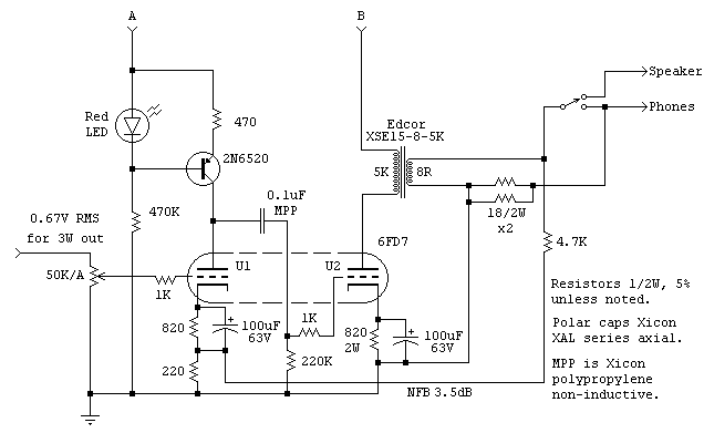

Did some more tweaking over the last couple of days.
Main circuit - only changed NFB resistor and dB value.
New F3: 19Hz to 23KHz @ 1W into 8 ohms.
Max clean power into 8 ohms, 2.85W. 3W @ roughly 8-10% (gotta build me a distortion meter). Of course, less NFB distortion correction = less output power.
Square response, ruler straight with only slight corner rounding on the bottom of the trailing edge, due to xformer above 5KHz. Ringing, zero. Spikes, zero. Nasty top-leading edge spike at extreme overload. Spike, not ring.

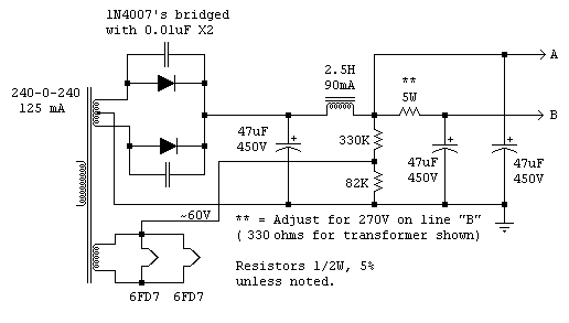

Power supply went through a bit of a makeover. C-L-C-R-C seems optimum.
Feeding the first stage straight to the second C. SS CCS makes the isolation resistor moot.
Because of the added C, the voltage went up and I had to up the "B" resistor value and watt rating.
Floated the filaments at around +60V for hum elimination (as opposed to reduction).
Choke could still be 5-10H though. 120Hz hum is about -80dB down. I'd like it better than -100dB.

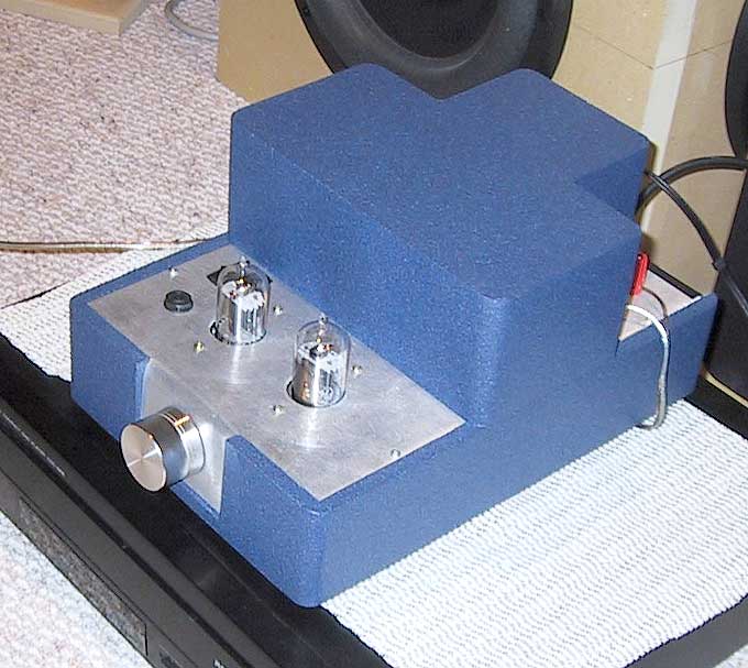

All put together for tomorrow's Northwest Audiofest 😀
Schematic with final specs.
Excuse my crummy digi-cam 🙄
The switch on the left is "speakers on/off" with the phones jack right below it.
Cool thing is the finish matches my speakers!
That's the power switch on the back. I had put it there to keep the AC wiring as short and to the point as possible to reduce hum. However when I did a bench test, I purposely swung AC line down the side it "would have been" for a front mounted switch and hum was not an issue. So the production unit will have the AC switch front mounted, opposite side of the chassis from the speaker switch.
Also the transformer is covered (I used a surplus Z-mount that was old and ugly) here. The future one will have an exposed Edcor XPWR-106.

Hello, I want build this amp but I don´t find the 2N6520 use for Geek in the plate on first triode.
I need replace 2N6520 what use ?
Use any PNP with a high voltage rating. Tweak the emitter resistor if needed to get the Va in the sweet spot.
