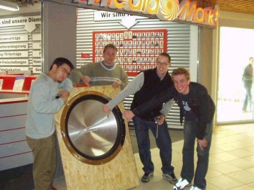

Not exactly cheap:
http://yu-ra.tripod.com/fostex/FW800.htm
a little cheaper:
http://www.magnat.de/content/carhifi/product_detail_de.asp?p=130616&pl=7, 8&s=10
