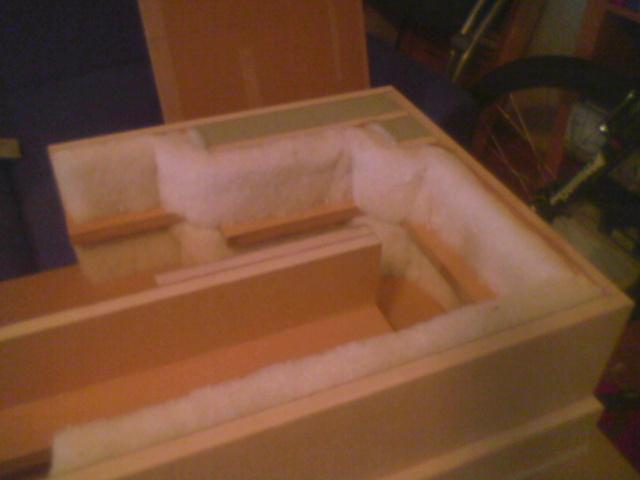

There is a thread on building the Cyburg needle, by the original builder himself, Berndt Burghard. It uses the same W3-871 that you want to use for sealed bass.
http://www.diyaudio.com/forums/showthread/t-47403.html
And here is a jpg in case that doesn't load.
http://img95.exs.cx/img95/684/cyburgsneedleeng7ie.jpg

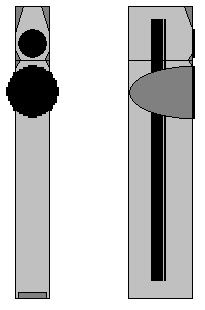

I would actually like to make the line overall width smaller than the larger driver. My plan is then to mount the driver in a large wooden cone, then cut out the top and bottom of the cone and mount this cone to the line and cut out the cross section.
It may be hard to picture, but just think of a cone with a TL running through it with all the necessary paths cut out. It will allow me to mount a driver larger than the TL in the TL and will look very pleasing in my eyes.

Relax said:I would actually like to make the line overall width smaller than the larger driver. My plan is then to mount the driver in a large wooden cone, then cut out the top and bottom of the cone and mount this cone to the line and cut out the cross section.
Sounds to me like you plan a visually interesting version of a Daline, which is a nice way to build a Transmission Line. A Daline is a cavity which empites into a Transmission Line. Since the cavity takes up volume, the crosssection of the Line is reduced accordingly, and the bass output of a Daline is very similar to a Transmission Line only with reduced resonances.
I have modelled Dalines, but not Dalines with conical cavities. If the broad bottom of the cone is the part which empties into the Line, though, I think it will work. We shall see later today.
One question. If your lower woofer-say, the Audax-is going to be mounted in a pointy topped cone, how do you plan on mounting the sealed 0.10 cu ft TangBand?
Similar, but the cone is actually in the TL. Like this:
basically no change to the TL, just a larger area to mount the driver. it would have similar, if not the same inner dimesnions as the TL would normally.

Let me get a handle on this.
The upper driver-the TangBand. That is supposed to be in a sealed enclosure. Yet your drawing seems to indicate a port connecting the TangBand's chamber to the TL.
What am I reading wrong?
I am sorry, the stripe on the side is just an idea for finishing.
Yeah, its the TB in a sealed enclosure up top with the audax or dayton in the tl beneath it.
