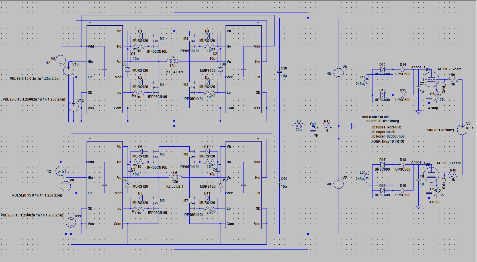

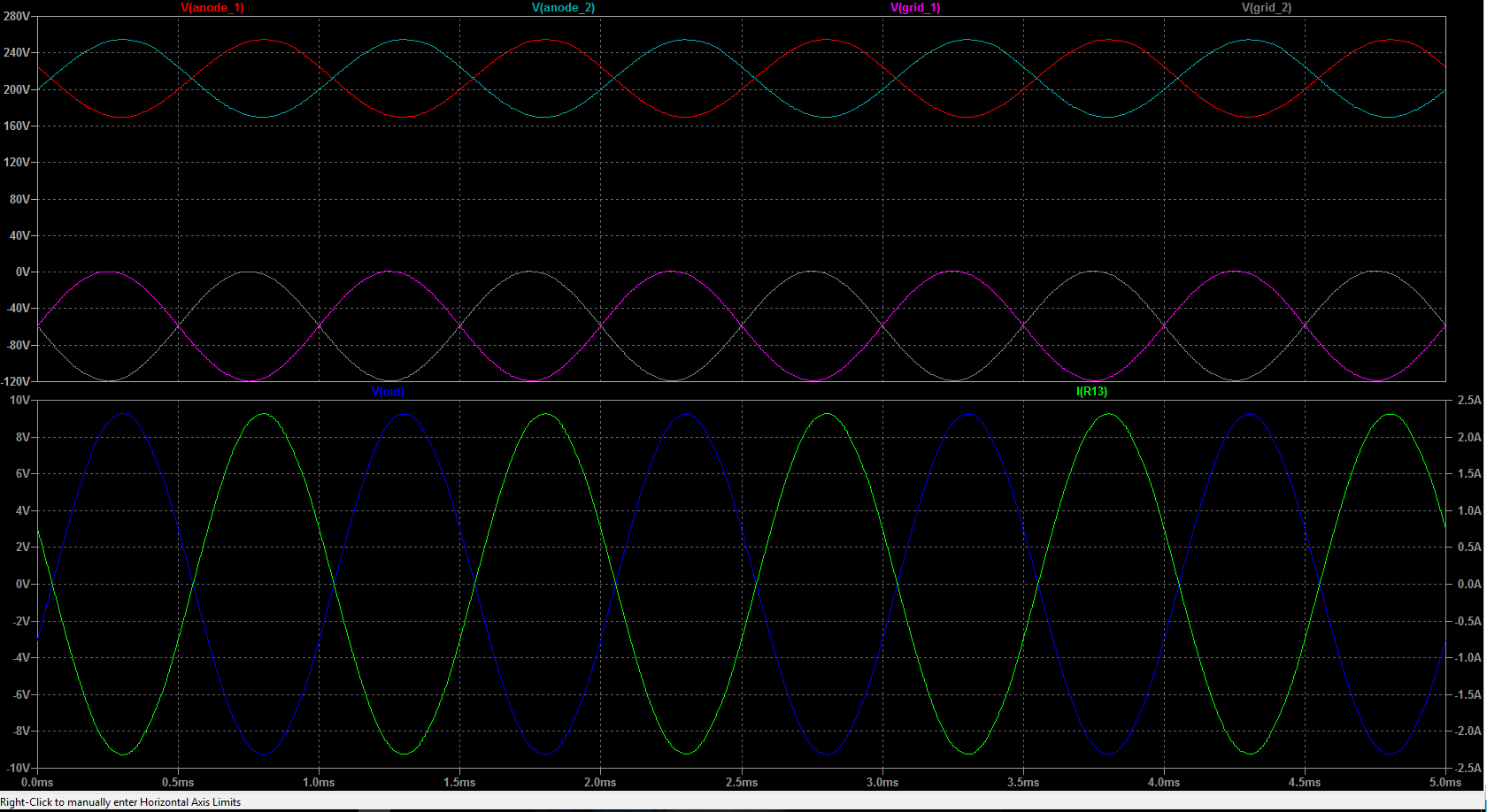

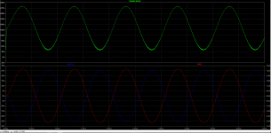

The simulation seems to work. Just need to make it somehow with only just one output tube
Update:
Some corrections from the last simulation where I have completely forgot about tube bias.
I hope it sheds some light on how this topology works. I will need to consult with some smarter people and try to get back with a closer to reality simulation.
Silviu

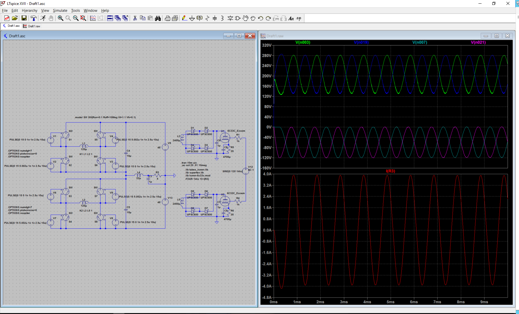

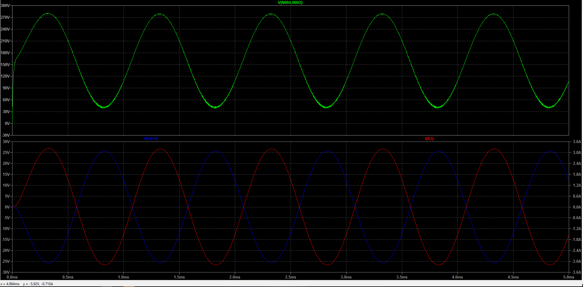

Update:
I managed to find some time and populated the schematic with real world parts and the results seem OK.
Unfortunately I don't really know if I'll start work on this project this year since I need to finish my 6C33C OTL Cyrclotron and my Balanced DHT Line stage and get my Quad ESL 63 panels refitted.
But I have all the parts for the DC/DC converters (I just need to wind the HF transformers).
In the meantime I have attached some screen shots.
Silviu
The 34kHz lowpass filter on the output seems a bit too close to the audio band for comfort, but that's easy to tweak. One major difference between the Berning circuit and the converter posted on the Tubelab site is the extra power supply on the secondary side in the former. If my understanding of the circuit operation is correct, the power to the speaker is actually being provided by this secondary-side supply, which really makes this a class D amplifier that's being amplitude modulated by a tube amplifier (instead of being modulated by the gate drive waveforms). On the other hand, the Tubelab circuit is what people in RF might call a "passive" upconverter and downconverter, and the power is actually being provided by the tube output stage. I don't know what kind of sonic differences this might lead to between the two designs, but I'm having a hard time convincing myself that the Berning circuit doesn't just approach typical class D performance as the THD from the tube stage gets lower and lower. Could you get the same sound signature from a tube preamplifier feeding a class D output stage?

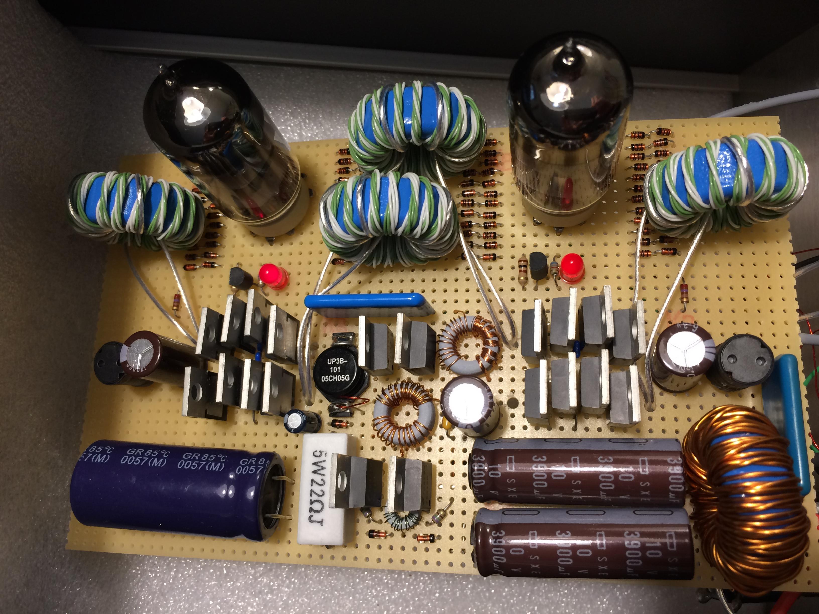

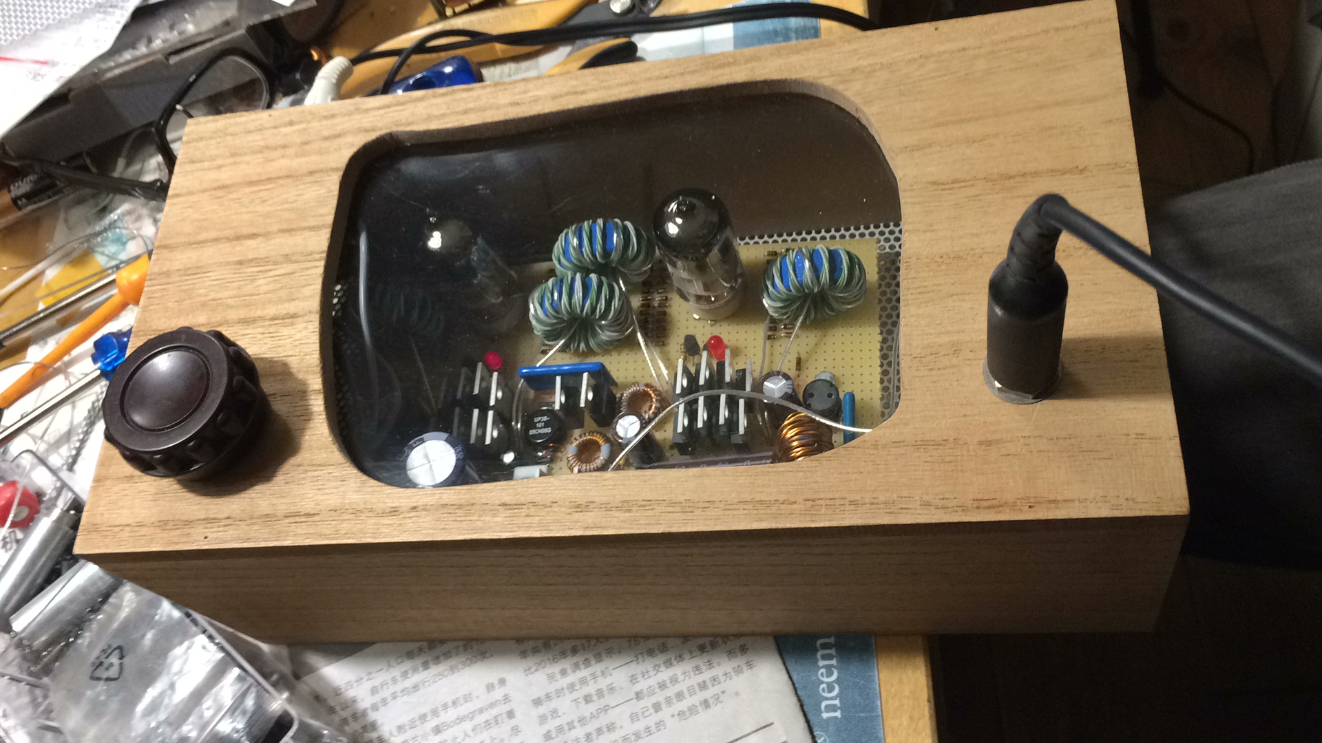

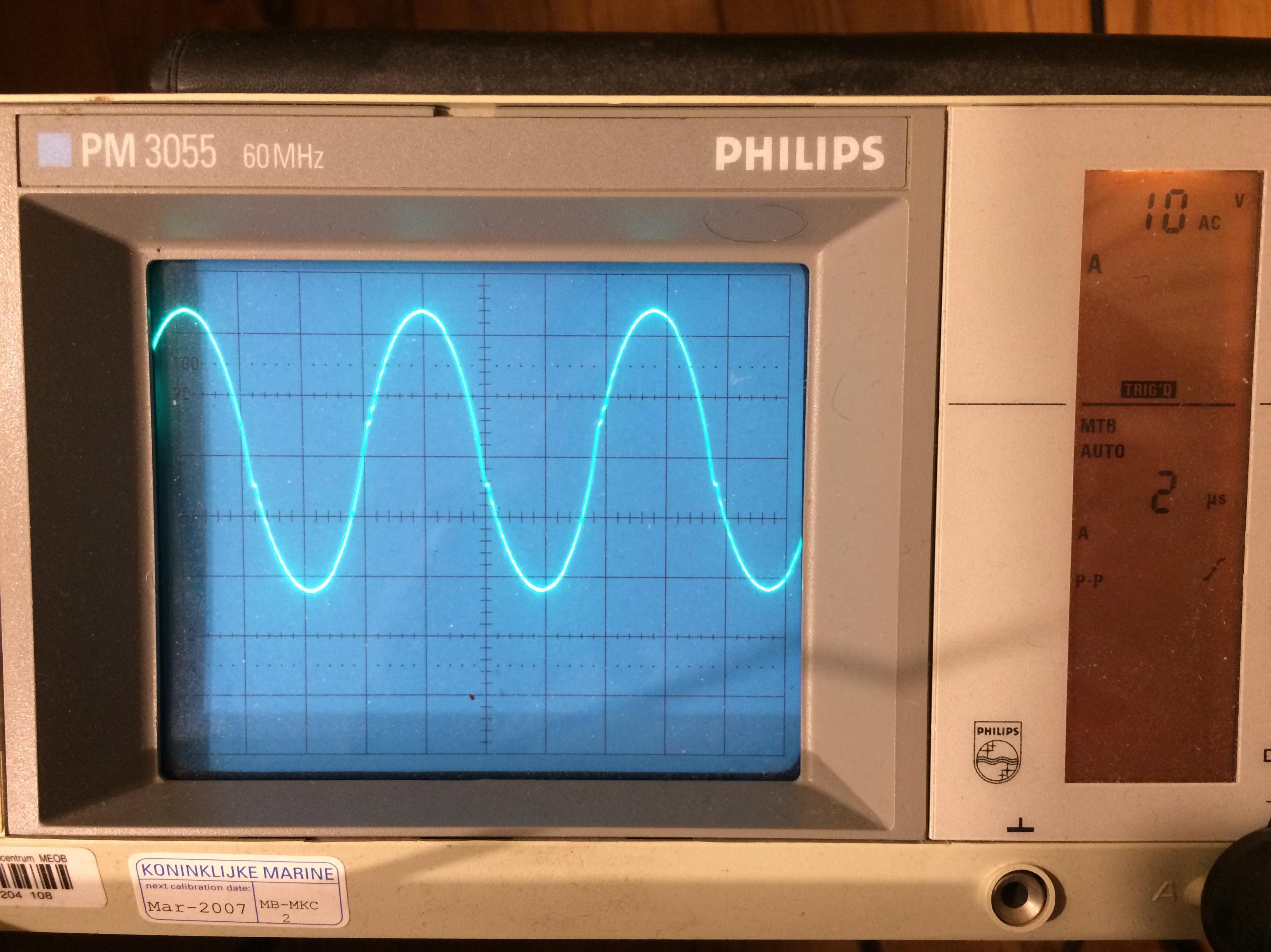

Hi Lampie,
That looks so cool... What’s the blue core material? What type of ferrite?
Did you avoid using a specialized IC for frequency generator and mosfet drive?
Can you share the schematic you use?
Silviu
