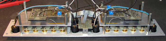

I plan to build a BOSOZ and this case I choose to use the Audio Input Selection Board from Seungyun Lee.
You can see some pics from his job here:
http://www.passdiy.com/gallery/zenpre-p1.htm
or here for the full project ( attention the site is in Korean):
www.diymania.net

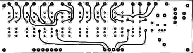

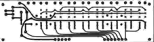

The problem was that for this board, he has made the PCB layer by hand and the scanned pics are not in a sufficient quality to make some good PCB:
Top:
Bottom

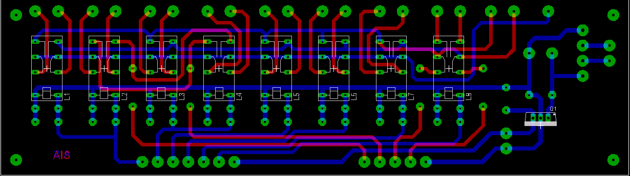

My board design is not new, is the same as the original one. The board was designed with EAGLE and looks like that:
In the attached file you find all EAGLE files and a copy in Gerber format!
The part list and the wire plan are available here:
part list
wire plan

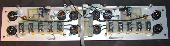

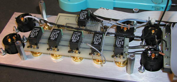

I think those are Swiss Altel. I bought them years ago surplus. No logic, just hardwired switching.
Peter Daniel said:If you are really serious about your design, you might go one step further and mount relays directly to RCA jacks, still using PCB. Something like that:😉
Yes it's an other good idea and it's maybe easier to build, thanks ! 😉
I saw them in FM Accoustics equipment so I thought they must be pretty good. Of course, it was 8 years ago. These days I would do extensive testing regarding sonic signature, but, I didn't bother then.😉
zeno said:What kind of relays did you use, Peter ?
Any surrounding logic?
Marc

I downloaded your zip file, but my light EAGLE software can not open the board file. It is saying the file may be damaged! I tried it with 2 machines and they are all the same! Can you verify if the file in zip is good?
Thomas
Alex:
Thomas
You should use Eagle 4.03
This should do the trick, No problems opening the file's. I also had problems opening the files, but after searching the internet finaly found the program. Be aware off a lot of cracks wicht you are directed to.
