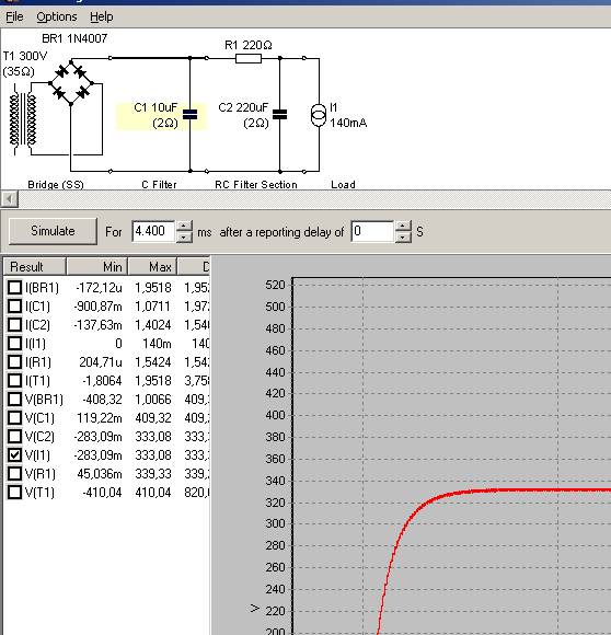

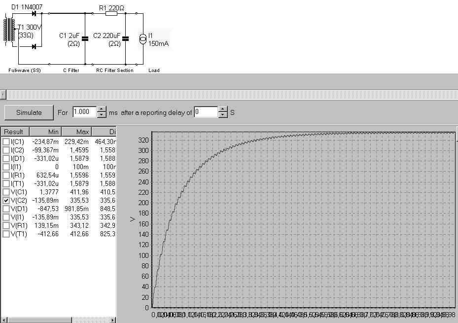

I've simulated and resimulated the PSU with PSU Designer, and I seem that I can't get under 350VDC with my 300VCT PT... :( :( :(
Any thoughts on what I could do? I'm alreading feeding 220V from the highest primary (it has international primaries)?
The only configuration that works is attached. I don't know if it's useful or not... surely a choke is less expensive than a whole new PT, but...

There should be no problem with replacing MJE340 in the ring-of-two CCS with a lower voltage device (it only sees 10V, or so) - I expect that gingertube just happened to have a lot of them handy. Similarly BC549 will work just fine in the cascode CCS (and BC549C would be even better).
Bas Horneman said:
How about a bigger voltage dropping resistor..
Hello Bas,
thanks for your reply.
But in your schematic I see that you've connected the PT in bridge mode, thus left unconnected the CT of the HV winding. But doing so, wouldn't you see 600V instead of 300 across the entire primary? In fact doing so I have something like 768V that's not so good for those EL84.
Could this be more likely? Please go easy on me :cannotbe: Sorry for the low quality of the pic but the forum software didn't allow me to upload a bigger image.
Also many thanks to EC8010 for his helpful reply. So I can replace the transistors with pretty anything, since voltages and currents are low.
Thanks EC8010, in fact I meant that, mantaining same "critical" parameters (max V, max I, max P) I undestood from you reply that the model of transistor is not critical. Of course whatever transistor I will use in place of the MJE340 I will mount a small heatsink on it.
Sorry, I'm not very good with transistors. I still can't understand why you can replace a MJE340 with a BD140 but not an ECC82 with an ECC83 :xeye:
