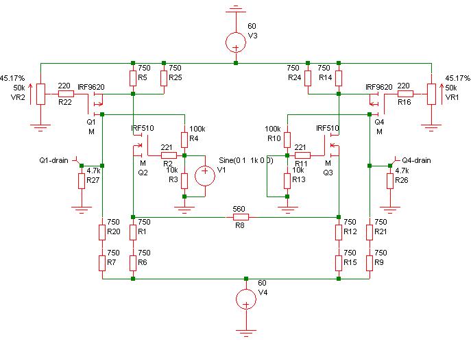

Hi Peter
It looks pretty much Nelsons patent.
I think You need some inputresistors, or you have to trust the outputimpedance of signalsource.
May be the value of R8 is too high, try to short it, and add some more feedback.

If You take away the folded cascodes, You end up with a simple XBOSOZ or a XSOZ for that matter.
As I remember, Nelson once talked about these folded casodes, and I thik his reason to implant these was to acheve better linearity at frequences higer than the audioband, >100kHz.
So do we need them at all?

I'm not sure how high it stays linear, but perhaps it helps keep AM (medium-wave, in Europe? 550kHz to 1600 kHz) band signals from producing modulation products that end up in the audio band?

With the folded cascode the differential pair sees a constant voltage then the bandwith become better and the distorsion low.
Not to mention the output swing.
Sure it helps drive such difficult loads like some x-son of zen back in the x-soz thread.

I would agree the second cascoded stage is not so important for small signal, audio frequency and low gain application. In this circuit, I intended to level shift the output signal to eliminate the potential dc voltage to a quite low value. This can be done by adjusting the potentiometers VR1 and VR2 in the circuit. Thus, the output capacitor shown in the original bosoz project can be kicked away. I don't like signal capacitors.
In this circuit, the original bosoz parts is still remained in and only two p mosfet and three 750 Ohm resistors are added. It would be quit easy to modify the original bosoz, if you had constructed one. I constructed a bosoz without pcb and preserve some space to upgrade.
I don't like feedback either. I would take out the resistors, R4 and R10.
I hope somebody can help to analyze performances of this circuit.

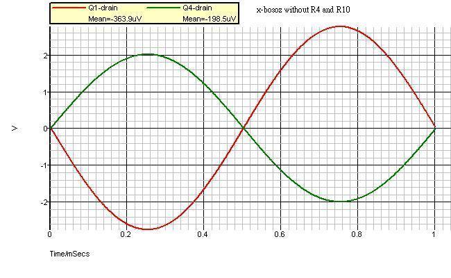

When I played around with this circuit , some months ago, I did notice that it didn't work if R10 and R4 were out.
...but I may be wrong.
Peter, I can understand your concern for feedback but if you take out R4 and R10 does this not take out the "X" and was that not the whole point of the circuit to have it?
Maybe I am missing something again...

Although it may become most complicated when you will build it ,
the best way ( since you decide to use it as a unbal/bal converter also) is to replace the power resistor(s) with active current sources. The best example for this matter you can find is on the
Aleph P schematic at Passlabs.com aleph page.

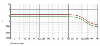

Here is a simulation of frequency response for this circuit.
There is a rolling-off at high frequency.
If the IRF9620 is replaced by the IRF9610, the high frequency response would be better.
Is there any idea, comment, suggestion or modification?

I built the circuit just 2 days ago .
First I say : it works with or without the R4 R10 (feedback / X ).
As a unbal/bal converter : I pull out R3 and R13 and add 2 resistors at the imput ( 2,2k ).
This circuit works , at my opinion , pretty good like a converter;
As usual I prefer to drive it balanced .
Well : it has a very defined soundstage , enormous from left to right , no noise (absolutely) and big dinamics.
It worths to be build and listen .
Nice to hear you build the thing! Do you happen to measure the output DC offset en input DC offset? How did you adjust them? Do you still use a 560 Ohm Diff pair feedback resistor? Why not go down to 47 Ohm and use feedback around the folded cascode?

Good observations...
Yes , the diff pair resistor (set the gain) 47ohm , is exatly what I use.
Also 4 matched mosfets (2 irf9610 and 2 irf610) all with same VGS
do the thing right.
At the output , 10 millivolts ; at the input a fiew millivolts but I still use coupling capacitors .
For trimming the cascode fets : 100K ohm from the positive supply rail to the gate pin of Q1 and Q4 and then a 20k pot + 30k ohm to ground is pretty good.
do the thing right.
Ah...
yes for the feedback as shown on the schematic above.
100k ohm for the start . I remember that X works good if the amount of feedback is 20 db .
