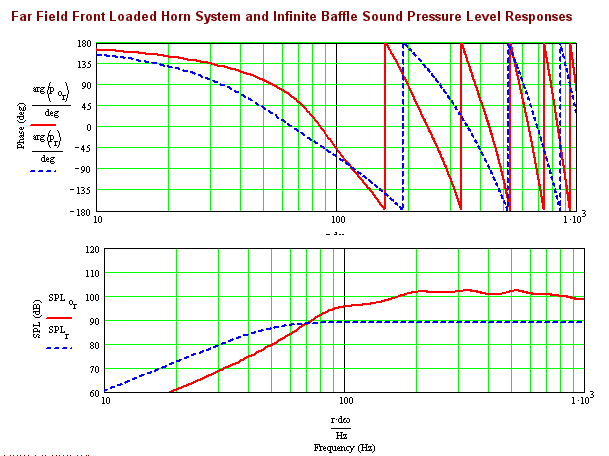

I'm no expert on front loaded horns -I've never had cause to model one before. However, after playing around in MathCad for a few minutes,this doesn't seem to be too bad, as far as FLHs go, for a first quick pass. It uses some of the dimensions Martin refers to in his FLH article, with modifications to the size of the rear chamber. Data entered is shown below, frequency response in the next post:
And here's the predicted response. Remember in these models, the driver is mounted with the rear venting into a sealed box, in this case with a front and rear area equal to 4 times the driver surface area, and 4" deep. It fires forward into a much smaller front chamber, with front and rear areas equal to 1.5 times the driver's surface area, and 2" deep. The horn is attached to the front of this. It's throat area is equal to the surface area of the driver. It is 21.5" long, and its mouth is equal to 20.2 times the surface area of the driver.
Well, it's a start anyway!

Thanks for running that for me, Scottmoose. 🙂 Looks pretty good, actually, but it looks like you used the data for the 208. 😀 The top (phase) plot is interesting, though. Now, assuming the 208, how do I go about creating the physical profile? Do I simply plug in the distance from the throat, etc. to the exponential formulae? My intent is to plot a template for a cutting tool to follow, so these can be turned from a suitable material, or to make a multi sectioned bowl, with the profile bent or cut into the sections. Ultimately, I'd like my large CNC router to do this automatically.
It is the data for the 168 -don't worry. The reference to the 208 is due to that driver being the default that's loaded into the worksheet. I changed the parameters, but I didn't re-name the driver in the title part up-top. Sorry for any confusion!
The get the physical profile, you'll simply need to plug the throat, mouth and length shown into the exponential formulae, as you mentioned above. The rear and front chambers are easy enough of course. I've no idea how you'd go about building one, apart from with great difficulty, but your above suggestions sound about right!

What did you set for the flare frequency? I was going to try running either 250 or 150hz. Also, I cant get the Sd in your example to jibe with the published specs: Moving piston is given as 60mm. The Sd listed in the factory specs states .0113m3, and I can acheive that result using the published number for "a", which I'm assuming is the piston radius. Is the factory Sd spec the one I should be using when creating the physical model?
Sd in Martin King's back-loaded or front loaded horn models is irrelevant. Hense the fact that there isn't anything entered by myself in that parameter; it's a bit confusing to begin with I know, but if you go to www.quarter-wave.com and read his articles on the design of horns, it will become clearer.
Here's a quote from the conclusions of his article on the design of a front loaded exponential horn:
"When sizing the front exponential horn sub-system, it is interesting to note that the driver’s size and Thiele / Small parameter do not enter into the calculations. The lower cut-off frequency fc determines the mouth cross-sectional area. The throat area and horn length are determined by the desired SPL boost above the lower cut-off frequency fc. Given two similar drivers that vary only in diameter, the same size horn
mouth would result for the same low cut-off frequency fc. The same exponential front horn could be used for similar eight inch and six inch diameter drivers."
What is the program that you simulated it with?
Martin King's Mathcad worksheets. You can get them for DIY use for $25; here's the link:
