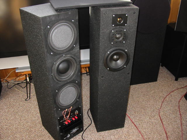

Ok, if you need a narrow speaker then perhaps consider a thin floorstander 2 way with a separate woofer. Maybe a 6.5 woof and a dome tweeter. Do you have a spot to place a woofer box?
If you only need 90 dB then you don't need PA drivers (public address or pro drivers) as they are known for efficiency and toughness, not necessarily SQ.
I would only recommend a dome mid if you have heard it and like it. It would be better in a three way without the separate woofer.
Under approx. 80 hz is non-directional.
I agree that if you have a separate woofer you should have a plate amp to power it. As CLC said, you can have the woofers and amp in the same cabinet as the rest. I have two sets like that, one with a dome mid. The picture is a 4 way and you can see the front and back. Maybe this is the way for you also. You can't make the exact speaker as I have used old and discontinued parts for these, but you can still do it with new if the idea appeals to you. It is really two cabinets in one. It's approximately 10" (25 cm) wide by 12" deep (30cm) by 44" high (112cm)
It can be done for $800USD
I also noticed I have repeated a lot of what CLC said, oops.
Cal

Cal Weldon said:Ok, if you need a narrow speaker then perhaps consider a thin floorstander 2 way with a separate woofer. Maybe a 6.5 woof and a dome tweeter.
I would prefer the one box solution anyway.
Your example is a 4 ways if I am not wrong.
So you think that 4 drivers are needed to reproduce the 50-20.000 range ?
Now I understand. Yes, 90 db are enough in my room.
No I was only asking if a dome would be better than a cone.
Very important information. Thank you so much.
I would prefer to limit the number of drivers to the minimum, that should be 3 if I understand correctly.

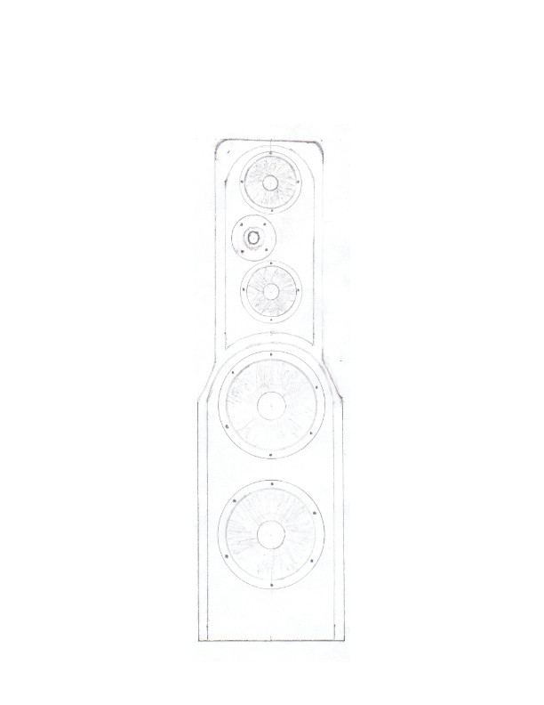

How about doing a MTMWW with (2) 10" Dayton Reference Woofers (RS270S8), (2) 5" Dayton Reference Woofers (RS125S8) and one Seas 27TBFCG tweeter?
The multi-drivers will help increase SPL a little. Not sure what the sensitivity of the 5" drivers are off the top of my head. With the dual 10", below 50 Hz should not be a problem. I would think you would be able to blend the 5" with the Tweeter ok. If I recall, the 27TBFCG has a lower Fs.
I have attached a concept picture of someone's design that I liked. I think it was posted on this forum a while back.
