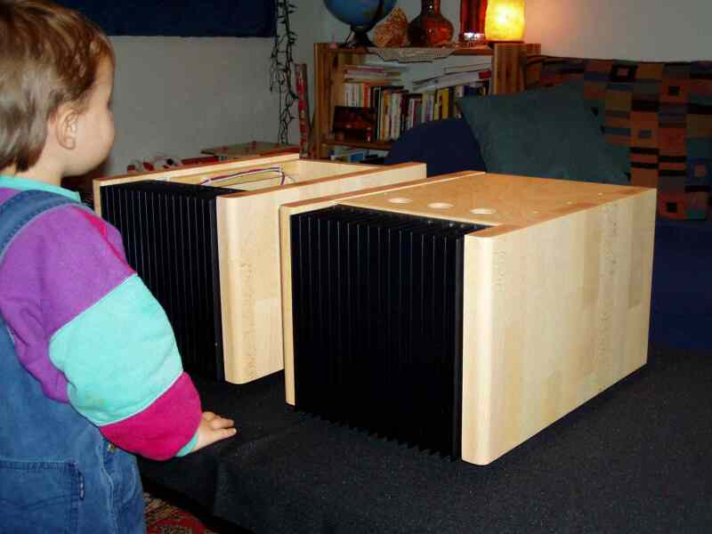

Finally i finished my ZenV4.
Sound much better then ZenV2.

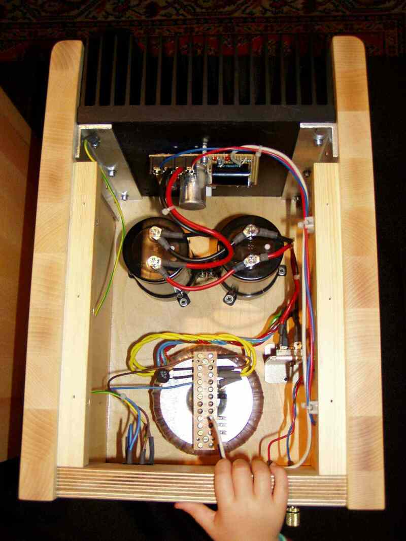

I use only a cap multiplier and no regulation.
V+ is 32V only and i`m using 0.15 ohm for the
currentsource and currentsensing.
No hum at all. A very nice Amp!!

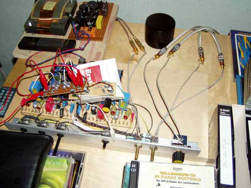

I add a picture from my speaker in development.
Fostex FE103 and 4 cheap 22cm bass, all as
dipols. Sounds great!😀
This chaotic piece is the activ crossover (Zen type).
Andreas

To Erik:
Sides are made of beechwood 27mm thick.
Bottom and top is made of beech multiplex.
All polished with hemp oil:drunk:

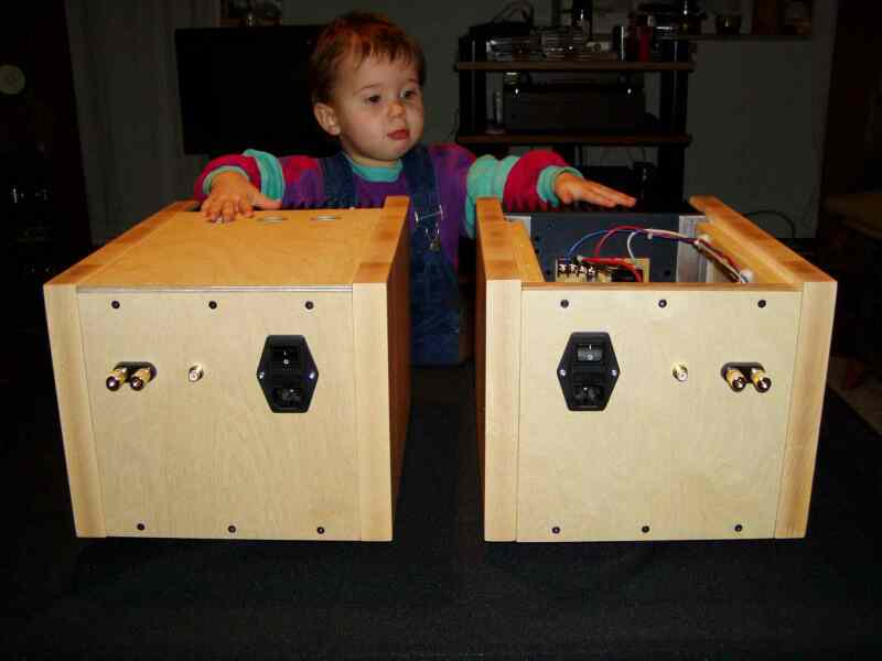

To fcel:
Maurizio is my 20th month old son and very
interested in electronic parts(big caps, potis,
and he loves the oszi)
He enjoy music only when it sounds good otherwise
he shutdown the cd player 😉
He loves to hear my manger system - he hates
his small portable radio.
Thanx for your comments.
Andreas:drink:
Q about placement of powersupply caps
I collect both powersupplycaps after the rectifier.
Is it an advantage to collect one of them
after the capmultiplier?
Since the aleph source dosn`t draw constant
current this could be an advantage,or not?
Andreas
