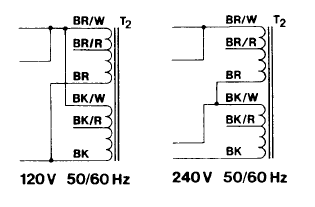

That was an idea that I had at first, until I opened the case and realized that the transformer only had a single primary.... leaving me stuck at a ~82VCT transformer putting out around +/- 56v DC 🙁
I think that this is one of the older DH-200 from the very early 80s.
Brian
If you have the newer transformer, here is a picture of the wiring that you would do to change it to 240v. This will just cut the output voltages in half, allowing you to use lower voltage designs, such as a class A amplifier. You should get around +/- 28-29v from it once you change the wiring.
Picture from the manual on the website:
http://www.hafler.com/techsupport/techsupport.asp?ID=3
Brian
