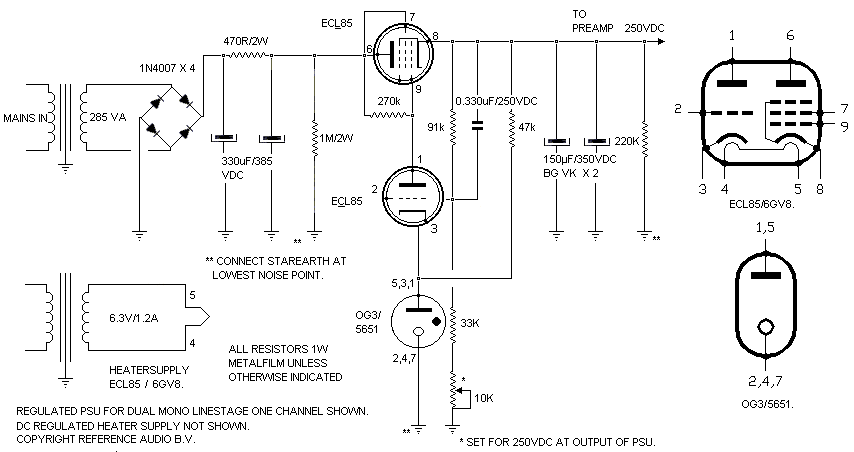

Anyone here tried this Regulated PSU from Gary K.'s website for a preamp?
http://www.the-planet.org/6GV8.html
I'd like to try this but with a 5V4G FW rectifier rather than SS diodes... An exact 250V +B is what I need for a project, and the current draw is around 34mA so this supply suits my needs.
The .pdf file schema linked in the webpage states that C3 should be 100uF, but the parts list indicates 47uF for C3. Should I just go with 100uF?
Anyways, I wanted to do a sim on PSUD2 for the 5V4G with either a small value Cap Input supply or Input R supply. Is getting the ballpark 'pulsating VDC' after C1 to modify the pre-regulated filter network a good start?
I got around 330VDC (C1) after I did a sim on PSUD2 (250VAC-> 1N4007 bridged -> 100uF-> 40mA constant current sink). So I tried to sim 275-0-275-> 5V4G-> 125R-> 100uF-> 40mA load for starters and got the same max VDC. Is this a good start, any suggestions?
BTW, I'll stick to R1 (470R) instead of the optional choke but I might try the OC3/OD3 option in place of the Zeners.
I tried to email Gary about his PSU but I didn't get any reply. Thanks.

I'm familiar with this regulator, works just fine. Should be no problem to use a tube rectifier in place of the diodes, just make sure the raw dc voltage is about the same.
Kevin
Hi Kevin,
Could you share some pointers on how to get the approx raw VDC from the original ss rectified schema via PSUD2? BTW, what is the purpose of the 470k (R8) bypassing the last 100uF (C2) cap just before the 6GV8 reg comes into play? Thank you.

looks like from the data sheet, this tube can handle more than the 34ma you require, it handle 5x more. but no one's stopping you from using this.
for an output of 250 volts, you need at least 350 volts at input of regulator, the triode connected pentode series pass tube need some voltage to work on, i am not sure how much exactly, but 350 seems ok. at 350 and 250 volts output, the series pass will be dissipating 3.4watts, just chek that is within the tube's plate dissipation rating.
so if you intend to use this rectifier tube, you need a power traffo of 300-0-300@50mA dc. you are limited to 10uf input cap as per data sheet. you can do a crcrc, with caps increasing as you move away from the rectifier cathode.
the 470k(R8) resistor is a bleeder resistor. provides for minimum current when idling and as safety feature.
it is ok to replace the zeners with gas-ion type vr tubes.
100V should be fine for a low current app working in Class A.

Thanks for the detailed reply..🙂 I have the tube lying around, so I better use it. 350VDC it is then...
I had a hunch it was a 470k bleeder resistor, but didn't know the real purpose of it in this application w/ a reg. Yes, I used 10uF as input cap for the initial sim, wrong choice power trannie though (275-0-275). I might also try CLCRCRC, since I have a spare Hammond 157J choke. I'll see if I can tame the choke induced resonance (resonant tank).

fred,
the datasheet calls for a plate to plate impedance of 100 ohms. dc resistance of your secondary ht coils plus inductance, best to follow this.
a choke will be good, but since this is a regulated supply, it may not be nescessary.
