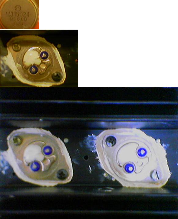

I bought two transistors MJ15024 and two MJ15025.
The MJ15025 is from OnSemi, and it appears to be OK...
The other is from "motorola", and their top just jumped out when I attached it in a plain heatsink 😡 😡
Look...
By the inside, can you tell me if it appears to be realy fake?

Hi Nando,
Motorola's parts have never poped apart like that. Pretty cool though.
They are garbage!

Both devices from the picture are fakes. Genuine devices doesn't have any white silicone layer and their die is so big that the amount of silicone shown in the pictures won't be enough to hide them anyway.

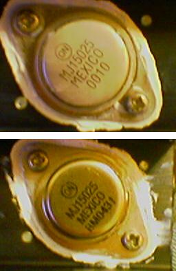

I took two pictures of my OnSemi's transistors... I'm not sure about them, maybe they're fake too...
They didn't opened like the "motorola", but It's not enough...
I payed 9 reais for each one, or 3,60 us dollars... NOT CHEAP too !
Should I open these others too?

Yes, they make fakes of OnSemi too

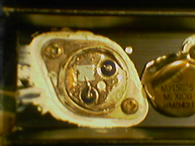

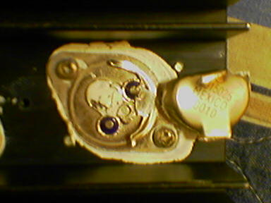

I opened them. One apears to be genuine, with much more huge wires, and without any silicon grease. Much more harder to open than the fake one ! 😱
The other, is the same trash as the "motorola"... Thinny wires, much more easy to open (but this didn't open by itself hahah), and the silicon grease. I tryed to remove the grease to take a pic, but the die separated from the body (
) and I lost it.
The first pic is of the genuine device. I don't know if it's genuine or a better fake... 🙄

This picture shows a genuine MJ1502x (the base bonding wire was accidentally broken while opening the case).
The one shown was a very old device (from late 80's) and currently manufactured ones are probably going to look slightly different, but note the size and fringed design of the die, the size and the tickness of the copper coin on which the die is mounted and the absence of any white silicone.

In the ealier pics, I noticed the lid of one of these fakes. Was thart the traditional Motorola "BatWing" on the lid? They are very particular about that logo. If it is not perfect they clean them off and do it again! Of coarse I dont' think Moto makes any descretes anymore. That is where ON Semi came from😀 😀 😀

The pictures on the first post have font that clearly looks fake... good fakes can duplicate the silk screening well... this is clearly a bad one.... lol even fakes have levels.
