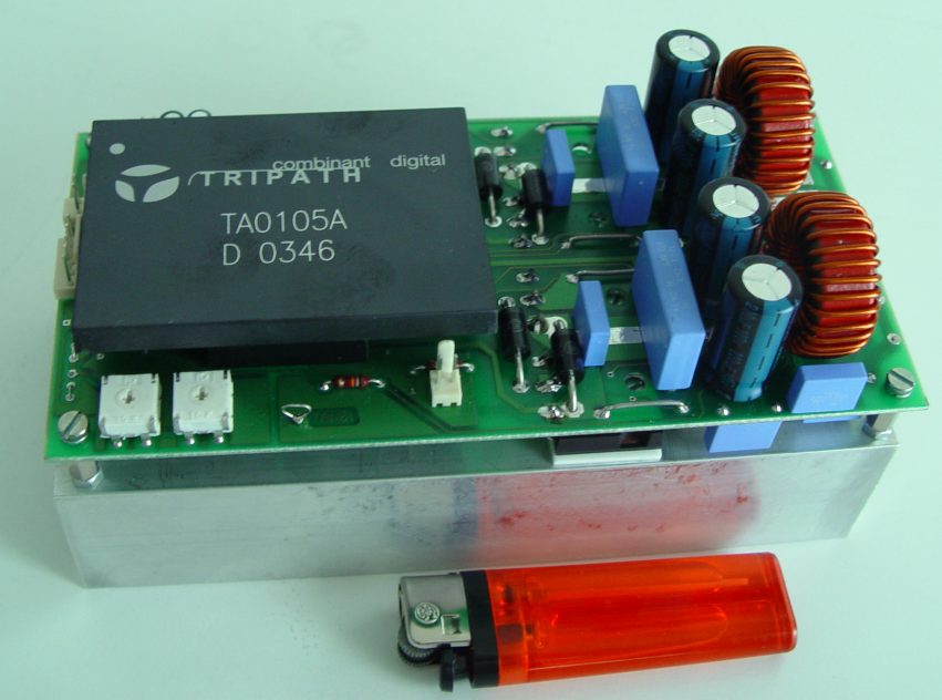

Hello all, especially Disney.
DF factor with Tripath is limited with filter coil and feedback type (pre filter), but bass control (and full range aplication)is not a problem, DF is only one parameter.... I have some practical experiences(about 4years) with TA104, TA105 and TDA2500, here is an example 1600W/4ohms module .
It is used in PA amps, in practical use with very good results in listening tests.
Try to look at www.bvaudio.sk (sorry, sites are only in slovak ), it is not to away ..

I have been looking at your site. Actually, I found that you state DF of 400/1kHz/8 ohm. Is this really the measured value of your amp?
From that picture, I can see that the module is probably bridged. So, in a non-bridged module, theoretically, it could be possible to obtain a double DF, because output DC resistance (mainly inductor winding) would be only one, instead of two in bridged mode. Do you use STW34NB20s for power switching?
How much negative feedback do you use?
Yes, it is measured, but just behind output coil.I have been looking at your site. Actually, I found that you state DF of 400/1kHz/8 ohm. Is this really the measured value of your amp?
Really, it si bridged (Ub +-80V), DF doubling in non bridged aplications is not true, I dont know why.Used Mosfets are STW50NB20, it is on drivers limits (Qtotal).From that picture, I can see that the module is probably bridged. So, in a non-bridged module, theoretically, it could be possible to obtain a double DF, because output DC resistance (mainly inductor winding) would be only one, instead of two in bridged mode. Do you use STW34NB20s for power switching?
Schematic is same as recomended by Tripath (but it is , very layout sensitive, like others PWM amps).How much negative feedback do you use?

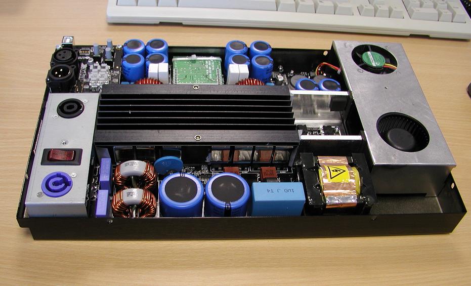

My Class-T Amp. Wiull develop 2x 1600w into 4R with DSP
Built my own gate driver circuits and use the TCA2002 which is Tripaths processor IC. We have a TCD6000 too which takes I2S digital audio.
Designing switching amps just takes a bit of care. I don't think there is any such thing as the ultimate sounding or best performing piece of audio equipment.
You just have to balance everything. Make it sound and measure well, make it reliable, compact and cost effective to manufacture.
