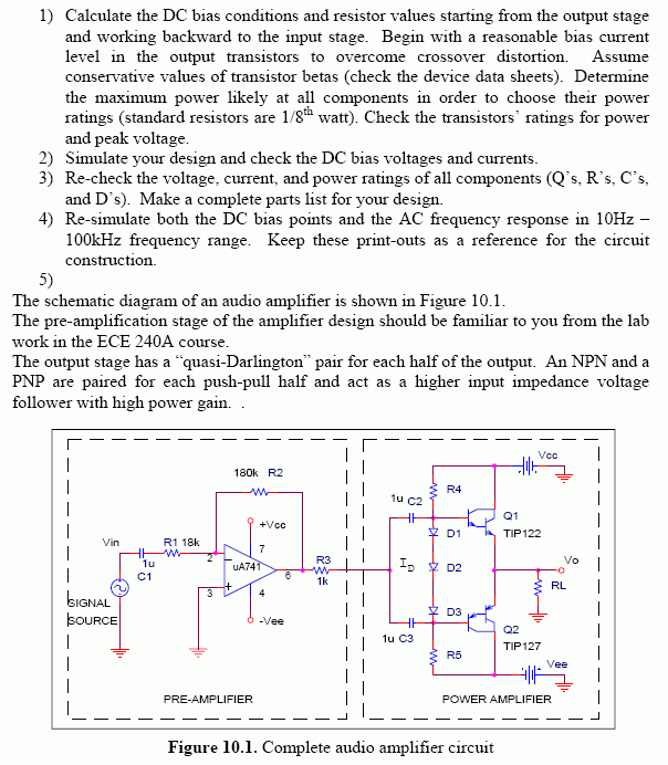

Attachment shows the basic circuit for
LAB10 Audio Amplifier

Bazukaz said:
Won't this amp run into thermal runaway ? I think emitter resistors are missing.
In fact this is a true Class B amp.
there is no bias in output stage ( or very very little )
'bias voltage' is set by 3 diodes ~3x0.6 = 1.8 volt
but to turn two Darlingtons on, we need, more than 4 Base-Emitter drops
normal turn on for one darlington is something like 1.0V
in this case we need a bias voltage of ~ 2.0 volt to turn two darlingtons
So 3x0.6V = 1.8V is not enough

davidallancole said:
Could you not use a LED at 2.1V in place of the 3 diodes for bias?
Yes, 3 diodes or 1 LED to set Volt at that point around which
Darlingtons begin to turn on.
(The usual VBE-multiplier transistor is also a good way to achieve this.)
I dont think either choice will be very much better, than the other.
Most important will be to find something, that can set correct voltage
at around 2-10 mA current running through.
This voltage should be like 1.8-2.2 volt for most Darlingtons.
The final fine adjustment you do by changing current in diodes/LED.
That is, changing the resistors that supply diodes/LED.
A little more current (lower resistor values) = a little more voltage = more bias in output.
A good target value for idle bias in output is 10-40 mA.
This will minimize crossover distortion at Class B operation.

Excuse me Sir if I resurrect this very interesting 3D after so much time.
I am extremely interested to the "power amplifier" half of the circuit.
I have some question:
1) if I would like to use a higher (about +/-40V) voltage supply how can I calculate R4, R5 and D1,2,3 values?
2) what would be more or less the input impedance of the power stage ?
Thanks a lot and kind regards,
beppe
Re: Re: LAB10 Audio Amplifier Project
It is very much about to get correct much current in them diodes.
when they have a specific current, they will have
a voltage between Q1 input - Q2 input
that makes only a few milliampere run though Q1+Q2.
this will set what we call amplifier idle current.
How much current will be in diodes and same current in R4 + R5
will depend on how much voltage supply you use.
You can replace R4 and R5 with trimpotentiometers
and so try and adjust until only some little current comes running into Q1+Q2.
You adjust trimpotentiometers, while measure current in for example Q1.
We can not say, without practical test, exactly how much current should be in D1,D2,D3 to make the correct voltage to turn on Q1 and Q2.
We can make with simulator some guess.
But we may mostly have to adjust for reality and small production differences in diodes/transistors.
This is called production tolerances.
A power resistor can for example have value 100 ohm +- 10%. ( = 90-110 ohm )
beppe
Just be aware Beppe that although you can increase the voltage on the power stage, it will not get you any more swing or power as the drive voltage is limited by the op-amp stage. It will just make additional heat.
Re: Re: Re: LAB10 Audio Amplifier Project
Thank you Sir for your kind and helpful advice.
Maybe I am wrong but the power amp section should act as a buffer. Am I wrong? 😕
Actually I have already what I think is a good quality circuit for a voltage gain stage (it provides 6 times gain for a CD player output). Its output impedance is very low, so that it can comfortably drive low input impedance stages.
Now I need a circuit for a high current buffer stage.
In order to make a complete amp.
I am very interested in this topology because is so simple.
I would like to use:
1) +/-40V for rails and
2) a stronger TIP142/147 pair for the output.
But I am not able to calculate those blessed R4 and R5. 🙁
Thank you very much indeed.
Kind regards,
beppe
The voltage gain is not the issue, the op-amp section can only swing within a couple of volts of it's rails, so with rails limited to 18 volts by the op-amp maker, it's pointless using higher rails for the power stage.
There are also better ways to make a power buffer than what is shown here, at least where providing a good quality bias is concerned.
I am actually in the middle of prototyping an amp using TIP142/147 devices, as you inspired me to design a simple, easy to build yet good performing amp when we corresponded about the Albarry design. It's all done bar some fine tuning.
