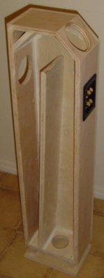

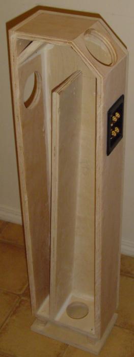

I can almost hear them. After about 2 years of planning, I am getting close to finishing up my first speaker project.
I finally figured out the secret, find someone with good carpentry skills to build the enclosure for you! 😉

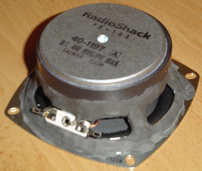

Today I bought some ductseal and have dammped the driver frames. The duct seal was only $2.32 at Home Depot.
The only thing holding back the completion of these speakers now is the lack of suitable damping material. I have been told that what I need is wool or cotton felt. Can anyone point me to a source of suitable felt? I guess I can go hunt down some old speakers, but that can be hit and miss.
I have attached a photo of where I am so far. I can't wait to hear these.

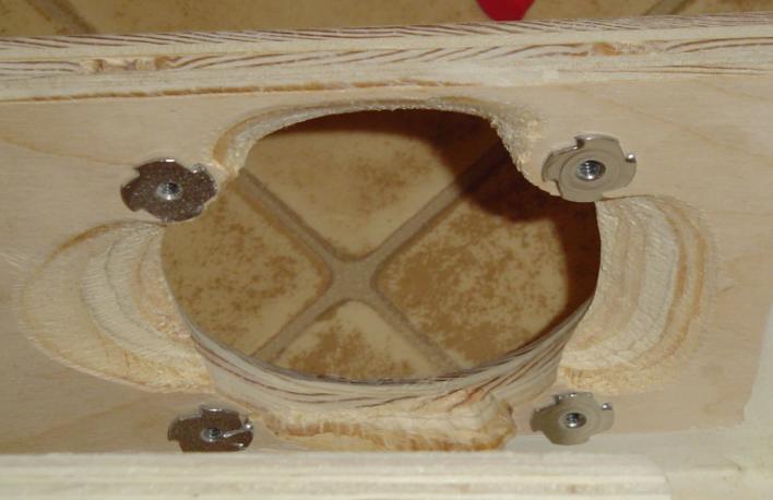

Champfered Driver Cutout
In looking at Dave's and Pete's pages on the BD pipes, I see no mention of a champfered driver cutout to give the driver more space to breath.
http://www.t-linespeakers.org/FALL/bd-pipes.html
http://www.pmillett.com/tqwp.htm
The baffle thickness I am using is 19mm. Should the driver cutout be champfered?
I know that a champfered driver cutout is used with the W3-871S.

It won't do it any harm, and might do some good, as far as I know. Bar advice to the contrary, I'd do it.

Scottmoose said:It won't do it any harm, and might do some good, as far as I know. Bar advice to the contrary, I'd do it.

I really should have thought of this before so it could have been done with a router. I guess I will have to do it with a wood file! Now I know for next time!
Hello GG:
Yes chamfer the inside of the opening. It will definitely help to allow the back wave to develop. Be careful though because you need enough wood to hold the driver anchoring screws. A router would have been best but that is hind sight so use the exacto knife. The amount of duct seal you used looks fine. I wen tone stage further and encased the magnet with duct seal as well.
If yoou can figure out the right length it is advisable to try and put a re-enforcing dowel behind the driver. try to do the front driver at least.

1197 driver
This is a great little driver. It is the driver that a lot of very skilled speaker designers "cut" there teeth on. It is very tweekable. Do a search and you will find some very inovative ideas for improving the sound. Phase plugs and "modge podge" make a nice difference. Good luck

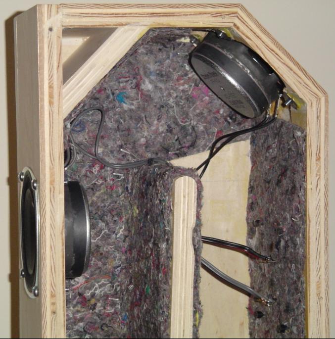

Cotton Felt
I bought some felt from a furniture upholsterer. I posted a picture below.
The front drivers are still breaking in (the rear ones were used and already broken in). Once that is done, I will take a good listen. After I am use to the sound, I will drop in phase plugs.
So far, I am very pleased with the sound.

Bracing
Due to the almost full length tapered divider, and the use of plywood, this enclosure is already very well braced side to side and stiff. If you haven't already permanently attached the side panel, all that's needed to complete the bracing would be a pair of vertically oriented 75mm or so wide pieces wedged between the center and front and back.
SCD said:That whittling looks pretty good.
Remember to add lots of bracing. Cabinet resonance sucks and needs to be reduced as much as possible.
Use single strands of CAT5 wire (24 gauge) it looks skinny but do not worry "Thin is in".
Good luck

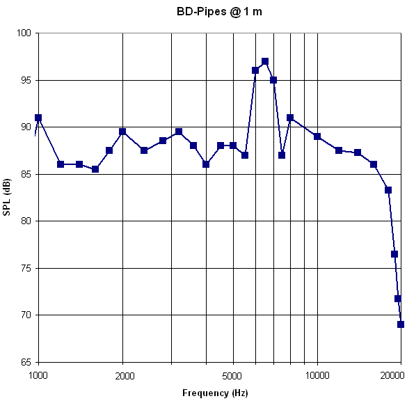

Measured Response of BD-Pipes
I have been playing around with an SPL meter and I came up with the following measurements of the BD-Pipes.
The attached plot shows measurements at 1 m so I have cut off readings below 1000Hz as I can't imagine they would be meaningfull. The measurements were made in a lightly furnished room 3.6 m X 6 m. The speaker was 1.2 m from the back wall and 1.8 m from the side walls.
The response seems very good with the exception of the spikes between 6 and 7kHz.
Response is very extended, dropping off slowly after 16kHz and dropping off very fast after 18kHz. These measurements are with the Planet_10 phase plugs. The plugs helped tame some, but not all of the upper mid-range brightness. To my surprise, the phase plugs extended the response by about 2kHz!
Other peoples measurements of the 40-1197 have not shown the peaks I recorded between 6-7kHz. I can't imagine the room would have any affect at that high a frequency and I don't think I did anything wrong. Any comments?

You here about it, and i have seen measures that show it -- none as big as yours. Have you puzzlecoated your drivers?
