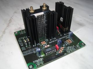

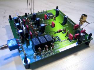

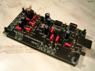

Like to share my new design with you all.....
you can download full document with circuits and pcb designs here:
Download PDF DOCUMENT here
image of the ready DAC Module board
Gott en Himmel!
It has an RCA jack for the SPDIF.......................oy vey.
Waiting on the .pdf to d/l..........and you-know-who to tell us the right way to do it. Cough, cough.
Jocko
Jocko

So, I can directly feed the DAC modules through I2S from the CDPRO-2M that is waiting unbuilt on my living room?
No need for reclock?
I plan to use a few cm of wire, but before I will search how to implement this not to upset Joko 😀

I would rather see you use I2S than SPDIF done in an "irresponsible manner".
Not your fault that is is a lousy way to transmit signals.
Jocko

Moin Mauricio,
try this:
http://www.semiconductors.philips.com/acrobat/various/I2SBUS.pdf
From memory: max. length for i2s is 20cm. Correct me, if i´m wrong.
For the rest (or most?) of us....spdif AND usb is the way to go. You can use your PC and "cheap" CD-Playa. No need or hazzle to dig in an old playa-model, trying to find a way to squeeze i2s out of it. So Doedde´s concept is right.
For some of us, there is the need to improve this concept. CDM-pro is prohibitive expensive and digging in ~20year old Playa´s isn´t that attractive (for me!). YEMV

Nope, don't have anywhere to point you, but...........
If I was going to run I2S from my CDP, I would look at LVDS. National makes several TX/RX chips that should work. If you can't find the info there, I may have propaganda sheet from them with the right P/Ns.
Yes, USB is probably the future. Especially for commerical efforts. This is DIY. Doing it the hard way can be more fun.
Hopefully better sounding, and more educational.
Jocko

maxlorenz said:
So, everybody is considering USB as a better option.
No, not everybody.
USB is ok. It has jitter too. I believe it is best to reclock both USB and S/PDIF sources. I did with my USB DAC.
