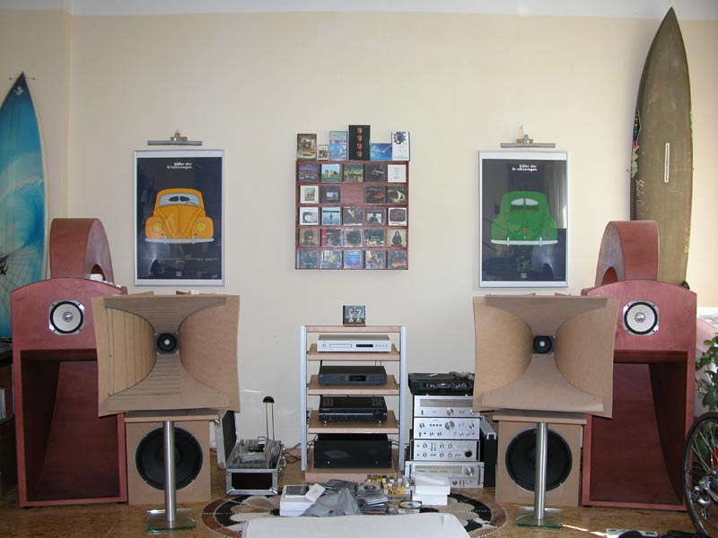

I have the Veravox 5s. It is a very very good fullrange speaker.
I have had it in a combination with a front loaded horn and an 15" woofer.
The volume behind the veravox5s was a bit smaller than 5ltr. Opening area was 60cmx60cm with a lenght of 25-28cm.

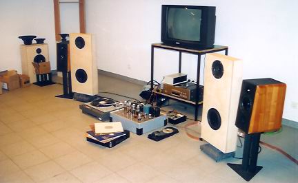

the Veravox 7X is out of production.
I have build up a new prototype called "Veravox 7X Cantare Signature" and demostrated it at the European Triode Festival end of 2004. It was a small open baffle with 8" subwoofer. Maybe some guys of this forum do remember. The people liked it. A B2** in comparison, for example, did not have any chance. It is planned to start production of this Signature version in the future. But this driver has got a hard paper suspension, so it doesn´t make any bass. You´ll need a frontloaded horn and an extra subwoofer in a Onken cabinet e. g. for it.
