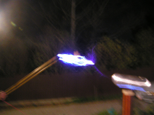

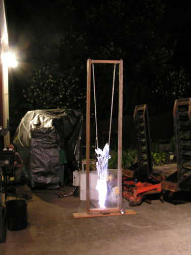

Its being eaten in a resistive ballast, talk about some gross inefficiency. The Jakob's ladder is basically just a big transformer shorted across an air gap. Heres another pic, taken after the ballast heated up, but blurry. The pink looking thingy in front of me are 14 oven boiler elements in parallel. Each element switched in adds 5 amps. Its hard to find reactive ballast of this power cheap. Using surplus pfc caps atm now.
Your right though, I doubt real power on the secondary is more than a couple kW.
