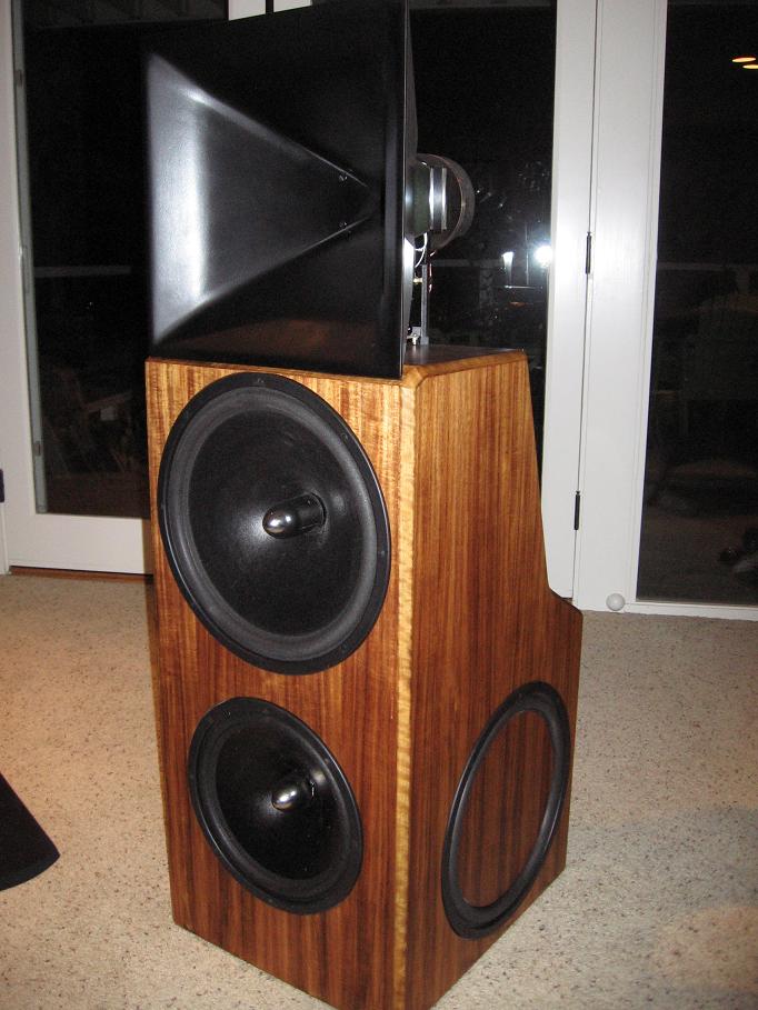

Finally got all the pieces and constructed the enclosures. The horn was Nick Mckinney's last unit. He supplied the horn, passive crossover components for the horn, and the mid drivers. I'm using TAD 2001 for the tweeters. The bass unit is a 15" Lambda TDX Apollo and the sub is a 12" Lambda TDX faraday motor with two 15" PR's at about 1500g each. The sub enclosure is about 2.5 cu ft (around 32L). As you can see from the pics, the bass is a sort of modified open baffle, or a short U-frame.
My ultimate plan is to have 4 channels of amplification per side. Because the horn crossover can be made phase correct, I will probably do that as an active line level crossover. The crossover to the bass and to the sub will be with FIR filters. I will do equalization with the FIR as well, much as discribed in this thread by John Hancock: http://www.diyaudio.com/forums/showthread.php?s=&threadid=17642&highlight=
I may do it by PC, but I'm leaning toward DEQX for now, as I'm not sure I want to deal with the steeper learning curve of the PC approach.
Here's the front view.

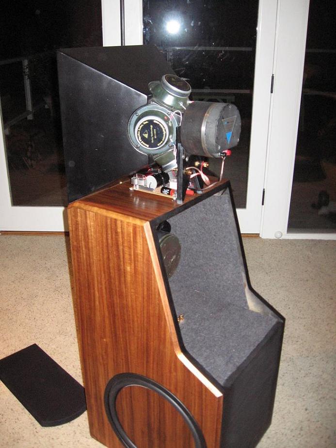

And the rear:
Oh, and you can't see it here, but I modified the entry holes for the mids, as suggested by John. That largely removed a resonance peak at around 2000 that was there with the larger holes.

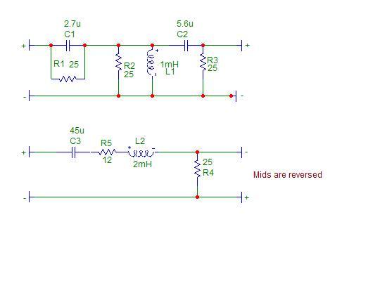

Here' s the passive crossover for the mid/tweet that Nick sent with the horn. I may use a passive here for a while, while I build the amps. I did some measurements and had a surprising finding. The tweeter run full range had the expected profile. It rolled off around 250hz, IIRC, and above about 2500 rolled off at 6db. With the crossover, it rolled off around 1200 on the lower end and, with the shelving high pass, had less roll off up high. The surprise was that there was a lot of lower frequency stuff in the spectrum that did not appear without the crossover. Why would that be. I'll try to post some spectra, if I can figure out how to record them from LspCAD (Just MLS). The program has an export function, but I can't find the images.
Sheldon
Nevermind that one. Turns out it was a problem with my measurement system, caused by poor connection. No such behavior on retest.

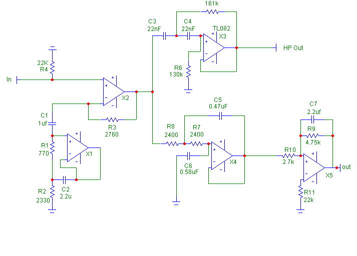

The crossover between woofer and sub is active line level. It's an 80Hz transient perfect filter (using a calculator from the FRD Consortium site): http://www.pvconsultants.com/audio/tp/tpdgam.htm
The overall response is then corrected with the room correction feature of the DEQX.

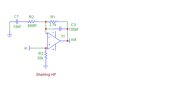

One additional refinement was to make two line level corrections to preserve max dynamic range of the DEQX. The first was to compensate for the tweeter response. In the constant directivity horn, the TAD response falls off above about 4.5kHZ, at 6dB/octave. So I added an active shelving HP filter between the DEQX output and the tweeter amp. Thanks SL for the info: http://www.linkwitzlab.com/filters.htm#6
After room measurements, I also boosted the region below 50hZ with a shelving LP. That way, the raw measurements were within about dB +/-, before the DEQX correction.
Here's the 80hZ crossover with the shelving LP:

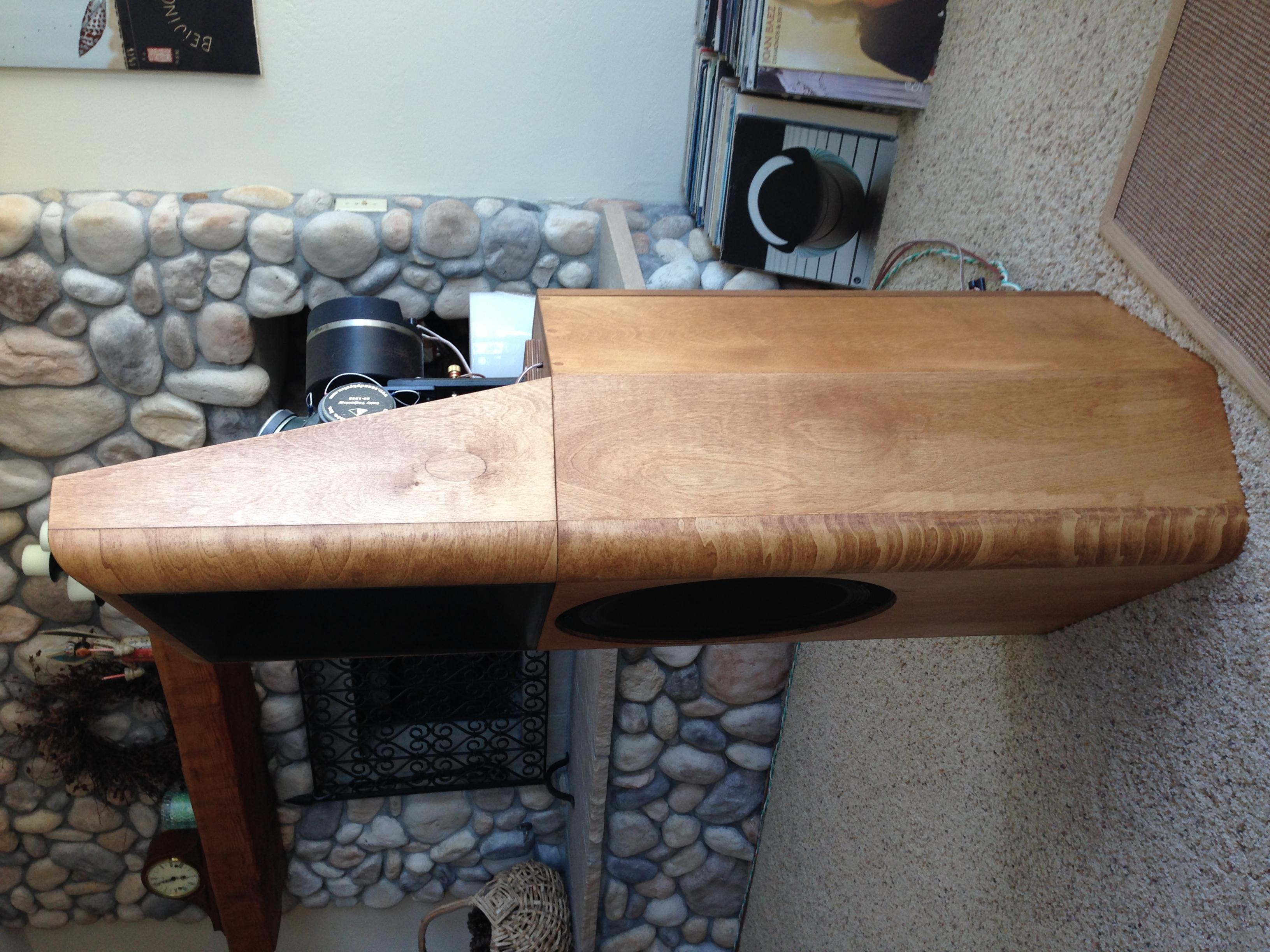

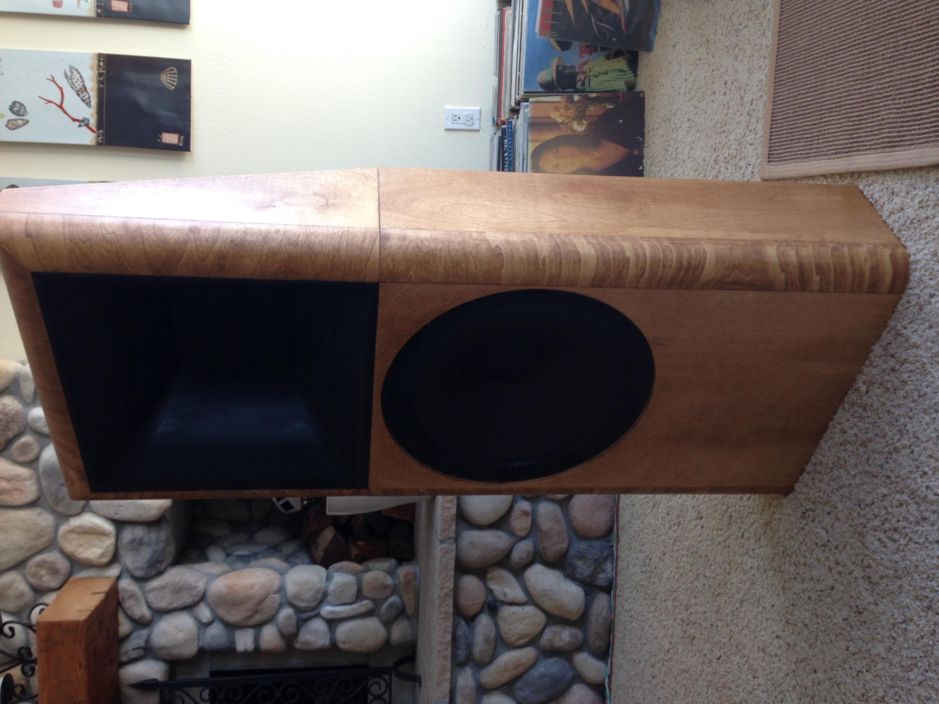

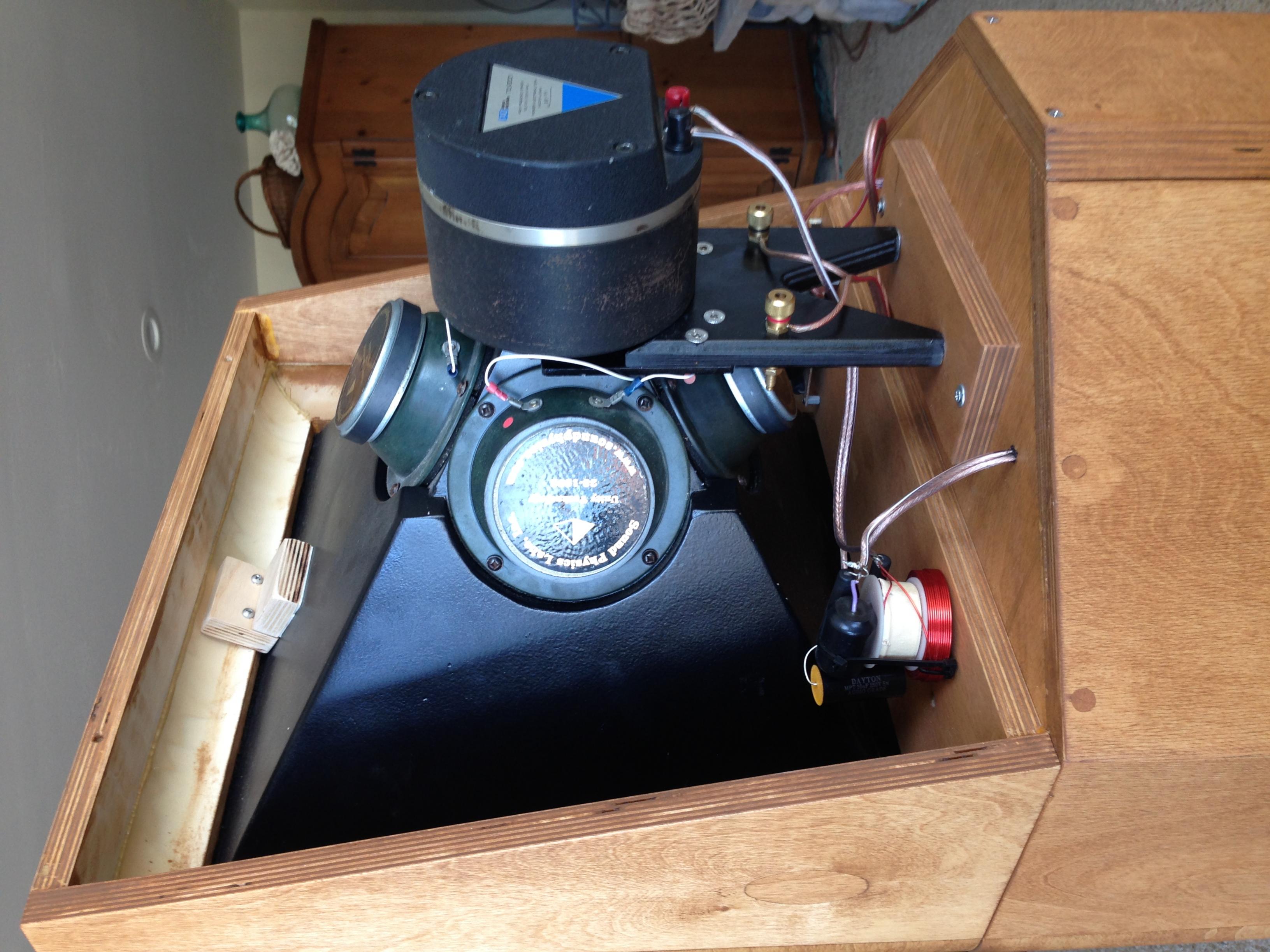

Rebuilt the cabinets. Changes:
Added 2" radius rounds to speaker front corners.
Bass changed from Lambda TDX to Altec 416B
Bass cabinet now sealed - approximately 3 cu ft.
Nine amp channels - compression drivers, mids, bass, subs(3)
Compensation and crossovers done by DEQX 2.6P. Subs driven by Mini DSP.
Passive compensation on compression driver and mids. I did this to minimize the dynamic range required of the DEQX for compensation, and to provide protection.
Mid bass high passed only. Output from bass channel of DEQX to input of Mini DSP. The three subs are integrated according to Geddes multi sub protocol. Mains start to roll of about 60Hz.
The DEQX allows input settings to be adjusted about 15 dB in the analog domain, so I can play with different amps and optimize for gain structure. In all cases I set up the gain structure to eliminate the possibility of clipping any of the amps.
I did initial in-room gated measurements with the DEQX to set up the crossovers. For setting up the subs, I used REW because DEQX can measure Left or Right separately but not simultaneously. Proper integration requires measuring under actual listening conditions.
I like what I'm hearing. Final step is to get the speakers outside on a quiet day and get measurements with as long a gate as possible.
Sheldon
edit: pics show up rotated by 90 degrees - not sure why.
