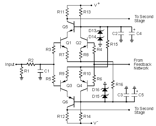

Leach Amp v4.5 uses two zener and some resistors as tail of differential input circuit .
i take the tail as ccs , in normal amplifier , tail ( ccs) is consisted of a transisitor and diode or LED
so the question is which one is better?

He is using the current through a resistor as the current source, with the zener providing a stable voltage reference so that the current is constant. His page explains why he did not use "active" current sources.
jaycee said:He is using the current through a resistor as the current source, with the zener providing a stable voltage reference so that the current is constant. His page explains why he did not use "active" current sources.
From Leach website:
Diodes D13 through D16 are 20 V Zener diodes which regulate the voltages that set the bias currents in the diff amps. Each zener diode is biased at a current of about 3.3 mA. Although a single zener diode could be used in place of two series diodes, I have found that the error tolerance in the voltage is less with the series connection of 2 diodes. C2 through C5 are ac decoupling capacitors which ensure the bases of Q5 and Q6 are at ac signal ground.
R15 and R16 set the tail bias current in each diff amp to about 3.25 mA. This current and resistors R7 through R10 set the differential tansconductance gain of the diff amps at about 1.6 mA/V.
- The diff amps use resistive tail current bias circuits.
- Not only do these generate less noise than active current sources,
but they provide a smooth amplifier turn-on that is free of thumps.
He has thought about alternatives but found this to best solution
mainly for 2 reasons.

Sorry, I find Leach's explanation, or excuse, for his simple cascode rather baseless.
2 BJT current sources using low noise small signal BJTs are not noisy. Zeners are.
My SKA and 300W both use 2BJT CCS's because of the superior PSRR afforded by them. Any they have NO turn on/off thump.
More of a throwaway explanation that doesn't survive scrutiny.
I tried both alternatives on my 300W amplifier (always keeping an open mind) and the sim PSRR result is here -

Hi Lineup,
My experience has been that simple resistive bias with bypass capacitors gives the best audition results, THD and noise (all)compared to zeners for cascode bias.
I used this on the Magnet 300F which was rebadged and won TAS Golden Ear.

The zener diodes serves 2 purposes in a good way:
- provide a constant current to input stage
- setting operation voltage for cascoding transistors in input stage
There are more sofisticated and maybe better ways to do these both things,
but no other such simple way, as Leach is using.

Hi Jacco & others,
the zener reference can be eliminated and replaced with a pure resistor string or LED string BUT the reference voltage does not have to remain at +-40V.
You could reduce down to a 2, 3 or 4 LED string or equivalent resistor string ( about 4V to 7V).
The CB capacitance of the input transistors would rise slightly at this lower voltage.
Q. Is CB capacitance an issue?
Q. Is more benefit gained by reducing the CE voltage across the input transistors?
is this voltage enough for the cascoded transistor, i remember, the 40volts also serves as base ref voltage for the cascode, so now the long tail pair operates at a much higher collector voltage?
