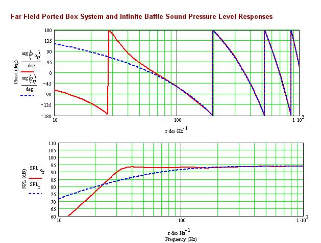

All I am going to do today is show you the new sheets, with a (very) rough sample input into them. So, without further waffle, we’ll get on with it. What is included in the new sheet? Sitting down? Good. Got a drink? No? Get one. Make it a double.
Welcome back. This is the part where I have a big grin. You’re going to like this.
The top part of the sheet is unchanged, apart from one thing that I for one find a Godsend. A little extra facility for calculating any extra series resistance you might wish to add to bring down a slightly rising response. As many people use SS amps with full-range drivers (Martin and myself included), I think this is extremely useful. If you use series resistance provided by a thin-gauge wire, then I would advise calculating this resistance in one of the several calculators available for the purpose (I use the one from TNT audio. I’m not a fan of their site particularly, but this is a useful little tool) and then enter it. It’s worth doing –you’ll get a more accurate response calculation. I won’t bother positing a picture of this part –you can imagine what it’s like.

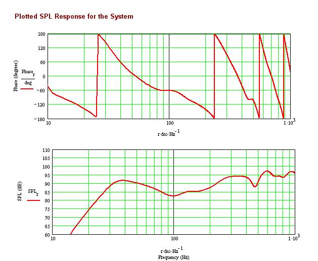

Below, I present the anechoic frequency response for what I term my ‘Small Thor.’ Like many others I’ve found the well-known Thor TL designed by Dr Joseph D’Apollito to be sub optimal, and have been messing around, coming up with some better cabinets for these drivers. (Ok, Ok, it’s an MTM 2 way, but that doesn’t matter, this is just an example. This design is also an MLTL rather than a vented box if it comes to that, but again, that isn’t an really an issue here. The sheet doesn’t care –it just models what you put into it.)
Enclosure size is as follows: 7.5” x 10.5” x 45” (WxDxH) internally. 0.5lbs ft^3 of stuffing. 0.5ohms series resistance applied. Driver centre (see Martin’s article on modelling 2 drivers in 1 enclosure for more on this) 9” below the top of the cabinet. 3”x4” port (WxL) 4” from the base of the cabinet.

So far, so normal. You could do all of this, bar adding the series resistance, in the current versions of the sheets. What then, I hear you say does the new sheet offer. OK, the facility for adding series resistance is useful and all that, but is that it?
Err, not exactly. You see, you know where the current sheet ends –you have a set of graphs presenting the calculated anechoic response, of which the last is the System Time Response for an Impulse Input? Keep scrolling on down guys. We have arrived at Part 2 of the new worksheet, and as you will see, Martin has only just begun. Because this new version of the sheet isn’t limited to ‘just’ anechoic anymore. Oh no. This time, we can calculate the in-room frequency response too. Yep. The in-room response. You can tailor make your new speaker specifically to suit your room and listening position. Anyone interested in being able to do that? Thought so.

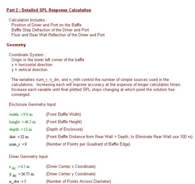

Right, Part 2. Here we go. The calculation includes the exact horizontal and vertical location of the driver and port on the baffle (which you can adjust, and you can select between a front or rear port this time too); the baffle step diffraction of the driver and port, and the floor and rear-wall reflection of the driver and port. You can see the values that I have adjusted for the Small Thor in the attached image below. Some I have not needed or bothered to change from the default settings; those are the values in black. Those I have altered are in green, as usual with Martin’s MathCad sheets.
As you can see in this image, we enter the exact external width, height and depth of the cabinet we are planning to build, and also, the distance of the front baffle (not the rear, the front! Thought I’d stress that as it’s easy to make a mistake) from the rear wall. All self explanatory, and very easy so far. Nothing to it; anyone who’s used the current sheets will find this a breeze, and even those of you who haven’t –well, rocket science it isn’t.
The next value you won’t be familiar with however. Here we can enter the number of points per quadrant of the baffle edge. The default value is 9, as you can see. Basically, when performing its calculations MathCad looks at a number of specifically defined points along the baffle edge to calculate the in-room response. The higher the number you enter, the more points MathCad will look at, and the more accurate the end prediction will be. I wouldn’t advise going for a number lower than the default settings –if you have the potential for greater accuracy, and you’re going to the trouble to use the sheets, don’t sacrifice it for the sake of a few more seconds calculation time. Those of you with processor speeds faster than the combined wit of the cast of Monty Python’s Flying Circus and enough RAM to cause a mainframe to blush can enter some higher value if you wish to get even greater accuracy. One thing to be aware of though guys, and I might as well let you know here as anywhere: these are heavy-weight calculations being made, and it takes time to run. You know it takes perhaps 5 seconds to calculate the response in the existing sheets (or Part 1 of the new one)? Well, this takes over a minute on my machine, which has a 2Ghz processor and 1Gb of RAM. OK, not cutting edge, but not too slow either. Average so far is around 75 seconds. It’s worth it though. The best things come to those who wait, so pour yourself a pint of Guinness while waiting for your PC to finish doing its thing.)
The driver geometry input allows you to position the centre of your driver exactly where you want it on the baffle, in both the horizontal and vertical planes. Note that there is another of those ‘number of points’, in this case across the diameter, that MathCad will use to calculate the in-room response. The default is, as you can see, 5, which I have left it at in this case.
We haven’t finished with Part 2 though yet. We’ve got 3 more sets of variables to enter yet, and these will be shown and described in the next post.

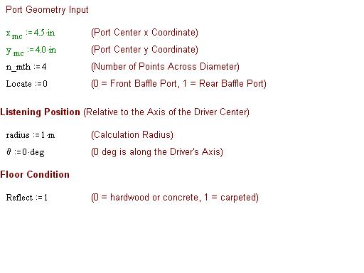

Welcome back. As you can see from the attached image, the three sets of variables we enter here are the port location on the front or rear baffle in the horizontal and vertical planes (and another of those ‘number of points’ values, which I again in this case have left at the default value of 4, but you can adjust to whatever you want).
We also can enter the number of degrees off-axis we listen to our speakers from our favourite armchair. Again, I have left it at the default value of 0, because I tend to listen to multi-way speakers like Small Thor on axis, but you, obviously, can adjust, and also experiment with, to find the best response and toe-in angle. I would suggest adjusting the angle in increments of 5 degrees until you find the best approximate response, then adjust in single degrees and refine that way.
The final thing you can select is whether you have a carpeted, or a hard floor. All you need to do here is enter a single number, 0 if you have a hard-floor, 1, if you have carpets. (Cork flooring –who said that?!? ;-)

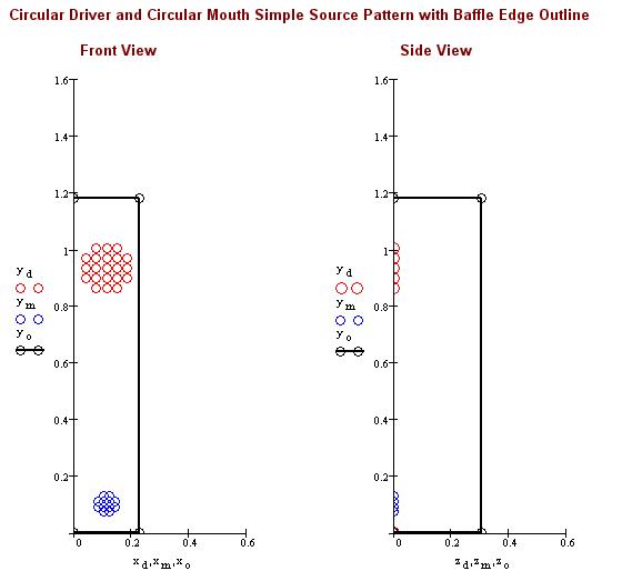

A very short post this. Below you will see the worksheet’s graphic depiction of the enclosure geometry you entered: useful for seeing at a glance if you have made a mistake, like putting the driver at the bottom of the enclosure, as I nearly did the first time I fired up the worksheet. Go on –have a laugh at my expense… (mutter, growl etc.) Again, this is for my Small Thor enclosure.
Completed the inputs? Good. Now scroll down, have a rest and a Guinness while waiting for the calculations to be completed.

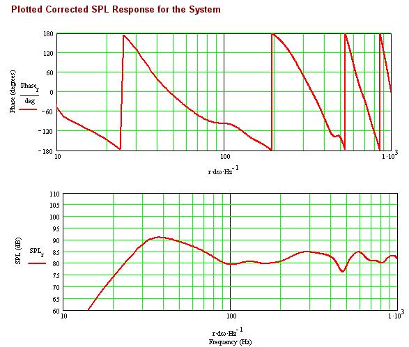

Aha. We’ve finished, and we have 6 new graphs. It’s the last two which are probably of greatest interest to you at the present time: this is the in-room response, as it stands, of Small Thor, on axis, in a carpeted room with the front baffle 32” from the rear wall.
Hmm. How gratifying. It’s not too bad for an in-room plot at all. (I've seen a whole-lot worse) There is, however, a bit of a baffle-step issue.

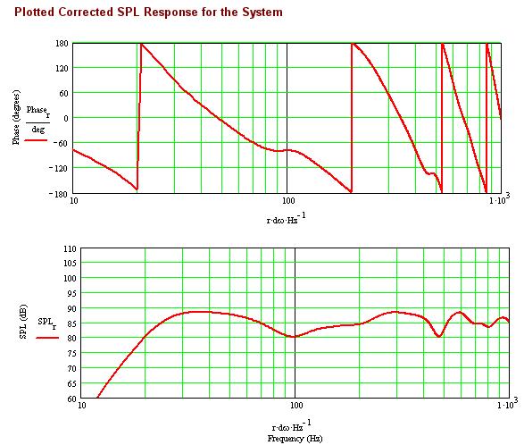

Welcome to Part 3 of the new MathCad worksheets. This is the BSC circuit designer. And guess what? Martin is a very nice man indeed, because the sheet has already worked out where the centre of the baffle-step problem occurs, and what it considers to be the necessary level of attenuation. It also suggests the values required for the inductor and resistor the circuit needs, and displays on a final graph (depicted below) the in-room response with BSC applied. You can adjust these yourself if they need modification. I won’t post a picture here of the input section –it’s all pretty obvious, and shall instead show the in-room response with the suggested BSC circuit applied.
It looks like the circuit has gone too far doesn’t it? Possibly. My interpretation however is that the circuit has flattened the response out, and extremely effectively, but the bass is overly prominent.
Compare the anechoic response, which is nominally completely flat, even in the bass, to the dramatic boost in these frequencies shown in the in-room plot, which I assume to be the result of room-gain. We can play around with the values we entered in Part 2 to try to rid ourselves of this unwanted, huge peak (a small peak can be quite effective, adding some weight or warmth to the sound, but 12db is beyond the pale in my view. Great for those home-theatre enthusiasts, but not so good for music) What is needed then, is a redesign of the enclosure which will result in a bass-response which will gradually fall away on an anechoic simulation, but when we factor room gain into the equation, will result in a nominally flat response. A modification to the basic enclosure geometry could also be desireable, as the 15ohm resistor requred to attenuate the predicted response in my room at least is going to kill the efficency stone-dead. Alternatively, I could try listening about 30 degress or so off-axis.
I’m not going into the different methods of achieving this –there are numerous ways, but that’s for another time. I’ll probably look toward adjusting the port dimensions to see if that can help out first, and also loose the 0.5ohms of series resistance I added in the first place to flatten the anechoic response slightly. If that doesn’t work, I’ll start playing with the cabinet somewhat. Suffice it to say however that I don’t subscribe to the ‘increase stuffing to damage the fundamental and thereby reduce the bass’ approach. A properly engineered cabinet shouldn’t need that.

1. Does it take into acount driver size and Xmax effect on low frequency drive capability? I beleive the original worksheets just told you how much excursion would occur regardless of the Xmax limits.
2. Does it take into acount Bl variation?
3. Does it take into acount listening distance?
4. Which resonance directions in box resonancd are calculated?
5. Can you just input non-standard design shape data fron CAD programs like the Alibre? Smooth horns are understood to react differently from piecewise straight curves.

Looks like Scott has been having some fun. Wow! I have to thank Scott for being patient, it took a couple of weeks for me to find a bug that prevented the new version from running with the free Explorer program. It appears as if MathCad changed the way a function worked between version 8 and 2000 and this had me stumped for a while. It ran fine on my machines but not on Scott's PC.
Some answers to the questions.
It takes into account driver size but displacement is treated as linear. I have added the ability to specify the input power and the displacement curve will be calculaetd based on this value. There are no non-linear terms in the displacement calculation.
No. What would you do if it did? How would you establish a BL vs displacement curve? I think that is beyond most DIY speaker designers, myself included.
Yes. Listening distance and angle off of the driver center axis are user specified. I could probably add an elevation angle to be completely general.
Same as the current TL worksheets, the long dimension of the enclosure. I have a 3D version of the Closed Box and Ported Box worksheets I wrote a tear ago but it has a couple of bugs that need fixing. So a 3D set of standing waves in the box is in the future.
No. All geometry is represented as sections of exponential expansion just like in the current versions. If you use enough sections then the shape will approach a cmoother curve.
The geometry of the enclosure needs to be rectangular with the driver on the front baffle and the open end or port on the front or back, nothing exotic. This should cover most of the DIY designs people build. The next upgrade will be to go to a trapazoidal baffle so that my ML TQWT design can be modeled. That will come later.
Not yet, but it could at some point. I will be adding an open baffle worksheet which is new to my site.
I think it will handle this but I need to check to make sure.

Next post I'll show a graph for the Small Thor MLTLs without the hefty bass response. After that -it's going to be designs and tweaks to different enclosures for Lowther PM6Cs (and no, I can't figure out why they're not more popular either). After that... well, we'll decide that when we come to it. Something I want to experiment with, with the Lowther models is the in-room response of wide-baffle designs, and their effect on reducing the necessary values in BSC circuits.

And here we have Small Thor, modified to flatten out the in-room frequency response in the circumstances I described above.
Little needed to be modified. The port has been raised by 1", and reduced in diameter to 2". That's it. (At this point, I will mention that I'm always a little uneasy about using ports narrower than 3", as I wonder about port-noise. However, other people have sucessfully used them, and this has done the trick as far as the predicted response goes.)
How did I do it? As I described above. I played around with the port dimensions in Part 1 of the sheet, until the anechoic frequency response prediction indicated a gradually rising response, which I was looking to achieve, then ran down the sheet and checked the in-room response predictions. Much better. The dip that I suspect was casused by floor-reflections around 150Hz seems to have moved up in frequency, and decreased in depth. As an added bonus, the compensation required by the system is much reduced -the resistor value has dropped by 1/3, and the inductor value has also been reduced. Listening slightly off-axis, like most people do (these are just examples) would mean that these values could probably be halved again. (I'm gessing there -someone please put me straight if I'm wrong)
Overall: not bad. Time now to get back to full-range drivers though. I'm suffering from withdrawal symptoms. So I'll indulge myself and look at a Lowther. In this case, I'll use the under-rated PM6C, which according to Martin is a very good driver for the money. I don't own any Lowthers yet, but I wanted a pair of new drivers for the New Year, and it's a toss-up between these and their smaller brothers, the PM55C. Think I'll go for the larger ones though. Bigger Is Better, you know... 😉
