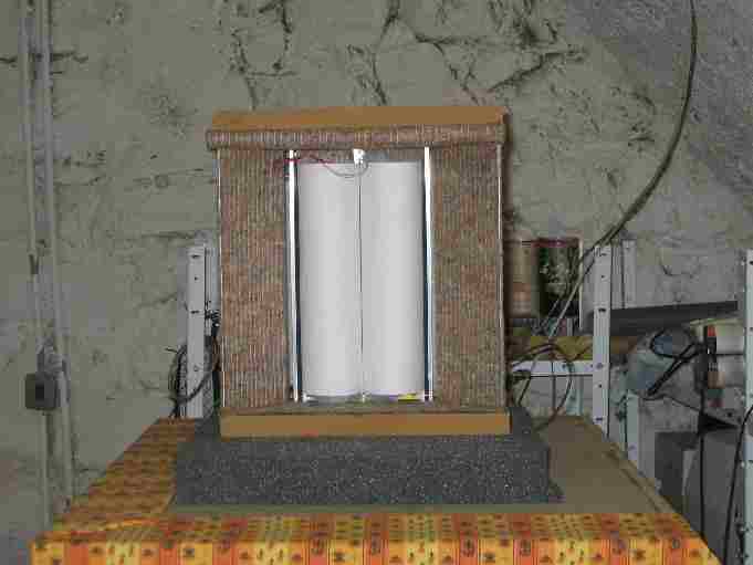

This French site with this 300mm
ribbon is very Linny like. I have 8 Linaeum
ET6s and I always wanted to get a tweeter
of similar design for an array. Maybe build
4 or these units per channel. Could all end up
a bit over efficient. Perhaps if the diameter
of the paper semi-circles were reduced one could
tailor the frequency and Spl for a specific use.
Great find well spotted !
Maybe do the ribbons in doped silk like the Linny originals.
Hope others experiment with this concept.

Hi
Have talked to Francois about his units
He kindly sent me a couple of pictures to share.
I am still waiting on some more details.
Regards
AnthonyPT

This design is so "simple" that it cannot be hifi. But what if it is? 🙂
I wonder how bad polar response Deminiere´s design has in treble since radiation area is so wide? Any measurements?
Would be interesting to test the idea with smaller design like 1" diameter paper tubes.

I understand this construction works and can be pretty good. I will build one myself to test the idea.
But I don´t understand how this construction could possible have good polar response in treble since both sound velocity in paper versus air and paper shape cannot match so well that it produce illusion of a single line source but at least two. And when those two are inches apart, as propably are, treble is good only right in front of the speaker. Also with smaller Radioshack tweeter not to mention this self-made paper speaker which polar response can be horrible.

I've made it in 20min using parts from my DIY ribbon tweeter, it is only the front part and plays just in horizontal position. It realy works, like for a DIY loudspeaker made in 20min sounds great. There is a potential in it!
I couldn´t quite understand how you make voice coil stay and return back exactly in the middle of magnets? Paper itself holds it quite well but you definitely need something more. Something like elastic band?
What else to use and how to attach it so that doesn´t affect to sound?
Hi
In the BIg French design the suspension of the sliding voice coil between the magnets seems to be held using covered elastic bands used in clothes. To get it to be stable may take a bit of experimenting.
The inventor of this wave bending design, Paul Paddock seems to have gone from small strips in his Linauem design to multiple small strips in his Aerfoil design to a solid full length strip in the new Aero design. This shows that the design is fairly flexible? I have been wanting to open up one of my 8 Linaeums to check the suspension but believe it it probably rubber of some sort.
For the 300mm Unit on the Web the cost of the magnets is holding me up at the moment !
Hope we can all see a result of our labours with these wave benders.

Paper is not an ideal material for this since it´s properties varies a lot depending air conditions like moisture. It changes sound velocity in paper and therefore whole radiation pattern with this kind of design. So if you adjust your system once it can work in a different way next day.
No good...
How about using FR4 for the whole diagraph, not just for the voice coil? Just etch copper away. 100um thick FR4 is ~120g/m2 compared to 70g/m2 with paper. Benefits:
1) Much more stable.
2) Diagraph can also be used to hold the voice coil in place between magnet gap and no elastic band is needed.
3) You can use thin copper stripes on FR4 membane to bring connectors out from the voice coil.
4) 1&2&3 makes it possible to build minimum gap between membrane and the box -> less acoustic short circuit between front and back of the panel.
