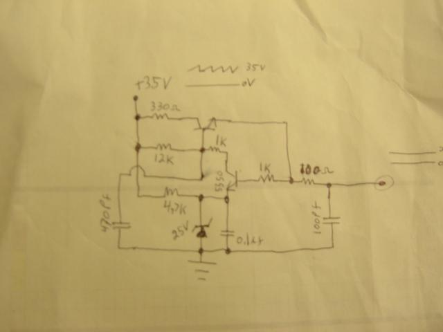

SMT's don't bother me unless higher voltages are involved, I just don't have a way to product PCBs. Still stuck at drilling holes, cleaning the board, connect the dots and etching.
-Chris
Hi Anatech,
When I was comparing 2 transistor to just 1, I noticed less voltage fluctuation with the 2 transistors. There was some RF occilation until I added the 470pf for stability and all was quiet.
As for SMD's, I just used cheap ready made general purose boards from Radio Shack of all places.:clown: The ones with square pads work well for bridging the traces, and the "daughter board" method works well for DIY....DIY IC's.😎

Hi CBS240,
I like that circuit with a little modification. I have not had oscillation problems yet. Drift is more a problem with the HV version.
I use a CCS to feed the pass transistor base, this improves noise rejection and load change behaviour for the better. My zener reference is fed from the pass transistor emitter.
I use this basic circuit for less than 50V supplies up to 350V supplies with component value changes. I need NTC resistors for the HV supplies to compensate for the zeners positive TC. Even tried zener strings, same problem.
Higher current, low voltage supplies get a darlington pair for the pass section.
-Chris
Ahh more added complexity. To me, complexity is not really a problem if the results are improved.😀 The CCS feed is noted. thanx
