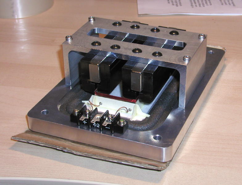

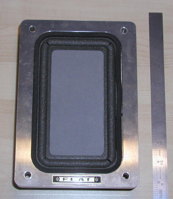

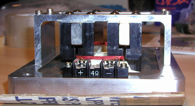

Looks like a Flat C with the membrane material of the Flat S. Is it new? And is it true fullrange? I saw a horrible price list many years ago, 3000$ per piece. Has that improved?
It indeed looks like FLAT C however it says Flat on the drivers, maybe the magnets were upgraded to C versions, but I'm not sure. Also, the prices from Bentaudio are much lower than $3000/pc, however, you would need to contact them directly for more details. I got those on loan, just to try out.

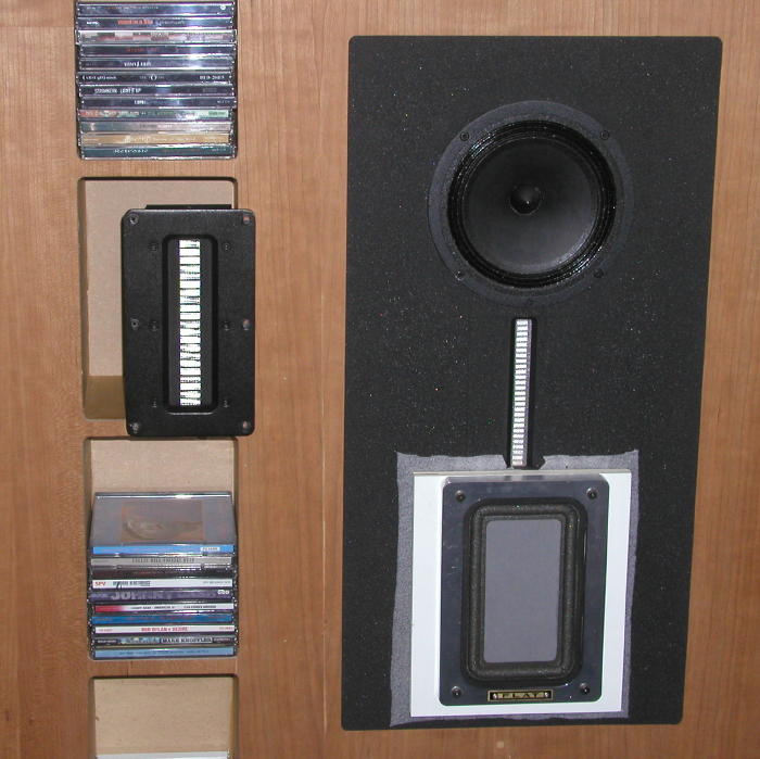

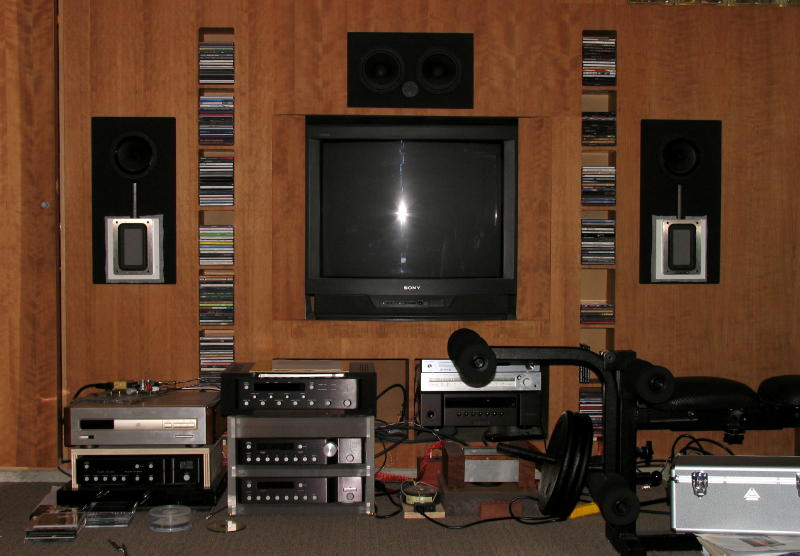

I was recently looking for some good drivers, Fertin and Supravox being considered, however, somebody from Europe (seems like FAL are more popular there ) suggested FALs. Since Bentaudio is North American distributor, I arranged for an audition.
I installed them already in my system. In the basement I'm using drivers mounted in a wall separating too rooms, so it's sort of infinite baffle arrangement. Normally, I have Raven 2 tweeter running above 12, or so, with first order crossover and Triangle midbass running full range. PHL driver on the bottom, crossed 1st order from top, runs below 1K and provides bottom end filling in.
With FAL, I disconnected both midbass units, Raven left as originally and FAL running full range (they supposedly work up to 10k). My first impression: amazing bass, really deep and well controlled. Seems better than what I had previously from two 6" units in parallel.
I can detect some coloration in a midrange. I'm not sure what it is but reminds me of the horns. Also, my GC runs in a bridged configuration at +/-34 V and combining it with 4 ohm driver may not be a good idea. All in all, FAL seems like an interesting driver and I'm going through very interesting listening experience. Now I imagine running two of those drivers per channel may provide quite amazing low end. No surprising that Japanese at the show placed sign "No Subwoofer here" 😉

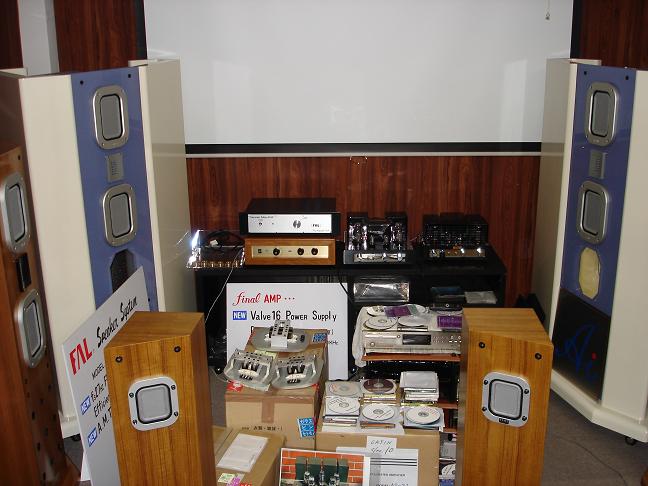

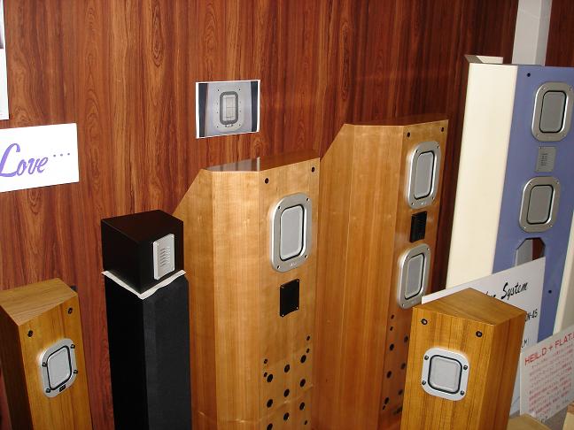

I had a chance to listen to the FAL drivers in their showroom in Tokyo. I was very impressed with the 3" model mounted in a BR. One of the best single-driver speakers I've heard. Although the comparison might be unfair because I've never listen to any other drivers in that price range ($1000 a piece). I didn't know how much they cost when I was listening. I planned on buying a set if they were less than $500 for a pair.

Originally I've replaced the MTM Triangle/Raven combo with FAL/Raven. Following some suggestions, I was initially using FAL full range, but for some reason, I couldn't get into that sound completely, as some strange coloration and ringing was always present. Finally, I measured FAL and they had some terrible picks and dips, but this characteristic indicated perfect candidate for low pass application below 2.7kHz. So last weekend I installed a coil (0.82mH) in series with the FAL and I changed the ribbons to Aurum Cantus GS1 (they are more durable at lower frequencies). While previously Ravens were used above 12k, this time AC were down to 3k (with a single 6.8uF cap crossing). I placed the ribbons somewhat to the center, because it was only available support space around ( I also attenuated them a bit with 10R series Holco 1/2W resistor). This combination appears to be very good, and so far, those are the best speakers I've heard in my house, truly a curtain has been lifted.
