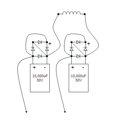

Like most other toroids, the transformer hates DC on the line.
Try running it with a large capacitor in series with the line. I
usually use two big electrolytics back to back (say + to +)
with a power diode across each one to keep them from getting
too much reverse bias.
Nelson Pass said:
. . . large capacitor . . .
. . . reverse bias . . .
Hi, Nelson
After having moved to a new apartment recently, I get somewhat DC from the wall AC power.
1. How large is large . . . ? 1,000uF or 10,000uF?
2. Is the small reverse bias to avoid the re-anodizing problem?
Thanks.
Regards
jH

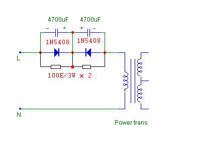

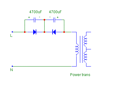

tested ,somewhere from net
I tried the above dc-blocker, but with 6,800uF/25V (small physical size) instead of the planned 10,000uF/50V. I arranged them for both F1 and BOSOZ.
When I turned on F1 and connected to J-Low (no others), about 90% of the buzz has gone from the transformer of F1 and the speakers. I could hear the very weak buzz when I brought my ear 50mm close to them. And, I connected all system and heard that the sound was cleaner, particularly with voices.
