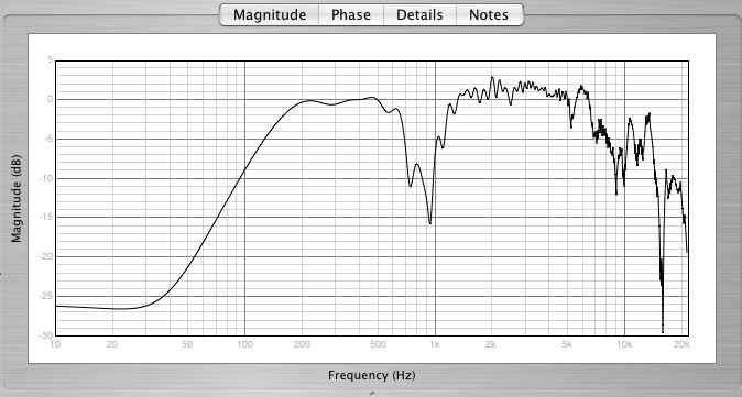

The german DIY speaker building magazine "Hobby Hifi" has measurements of the FE108EZ in the latest issue (1/2006). Their verdict is simpy "unusable". The main problem is a dip from 400Hz to 1500Hz of 10dB. I always thought something was wrong with my B'horns, but it seems to be the drivers.
I'll try to encounter this problem with some active correction circuit based on this project (pots only to be used while measuring).
Next time I'll do measurements before doing anything else; Fostex' data sheets cannot be trusted (HH also measured the FT17Hs; the resulting data was also quite different from the blurb).

Yeah they certainly aren't flat. I don't consider myself to be part of the golden ear club or anything, but they still sound pretty good to me. I'll be interested in what you think after the EQing. In fostexes defence, I'm not sure I would really completly trust anybodys FR graph of a driver they are trying to sell to me.
Joe
attached a nearfield measurement of my fostex 108 in a 2-liter sealed box.
http://www.madisound.com/pdf/fostexdrivers/fe108ez.pdf
I think it should be noted as well that fostex HAS a 5 db dip at 1K and a 3-4 db dip at 600 and a 4-5 db lift above 3K on their chart.
Thats a 10db difference between 1k and 4k, very honest in my book.

Their measurement looks startlingly similar to (possibly a little worse than) the stereophile measurement of Eds horns a while back.
It also seems to be very similar to Nelson Pass's measurements.
