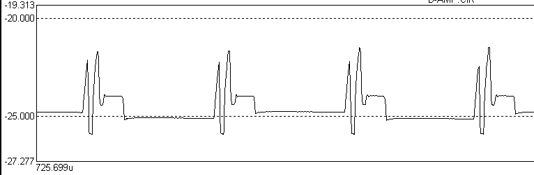

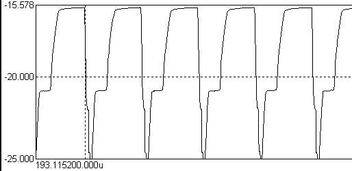

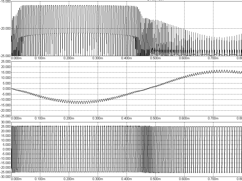

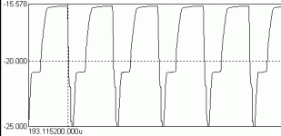

Here are some simulations: low side MOSFET`s gate signal, output after filter and output before filter. It ticks at ~320kHz, seems to work fine.
Lowering gate resistor 12->1 Ohm noticeable lower THD (zero crossing artifacts)

Tripath may corrected the distortion by gigantic loop gain of delta-sigma converter.
Genral self oscillating class D couldn't fully eliminate cross-over distortion, as experimented with a crappy output stage.
So the question is, how do some class D designs solve this problem, and how can it be implimented into this cicuit?

Kuzmenko said:
I mean- I don`t like BOTH of half- wave:xeye: :xeye:
Is there are some troubles?

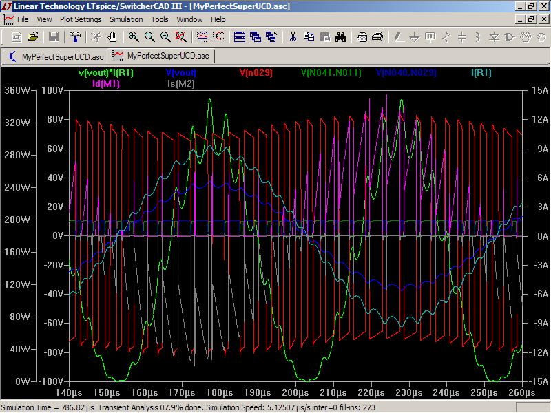

That's about as good as I"ve gotten them to work in LTspice as well. It can be made to look very good at low power, but crank up the input and that's exactly what happens.
This same behavior isn't observed to such an extent on Pspice so I'd imagine it has to do with the simulator. The question being which is truer to life?
I'm not saying that wouldn't occure in the actual circuit but perhaps not to such an extent.
Chris
