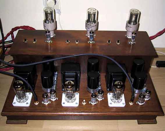

Finally completed my tri-channel amp...suitably called frontrow..rugby fans will now what I mean..if not still a meaningfull name puts you on the frontrow of a cinema/concert ;-)
Have listened for 2 evenings now and it ....well... it makes me a proud and happy man..

Thanks for the compliments...
What DHT did you get? that broke...I have a couple of russian GU 13 that I want to use in a future ..future project... a guitar amp is also a project that I want to do..just for fun...i don't play guitar ...but what the hell
The woodwork is pretty plain..2 boxes with a top...that has a profile routed in...but it turned out quite nice if I may say so myself..
It sounds very good...tremendous detail..nice mid's and high..bass is not super..but can be improved if I bypass the cathode..even then it is not super but that is also limited by my speakers ofcourse (mission761) but i find that that muddles up the mids a little.(cathode bypass that is) .so i've actually left it unbypassed..
...it's the best amp i've ever had/made....I still can't believe I actually built it..and it works? Hum is only audible if I put my ear to within 1meter of a speaker..It worked right "out of the box" so to speak and I had to do no debugging to get it this quiet.. it's choke input and I did not know that choke input could be so quiet..i always thought that it would be noisier...

Hi South Africa,
Congrats on your amplifier.
Time to debug the residual hum now?
Subjectively cathode bypass caps do slow down transient attacks and dynamics don't they?

Last night put up in a 15uF Audyn cap as bypass..so if I understand correctly I'll have everything above around 20Hz fed back..but the treble sounded horrible that way...so I added a 0,056 russian teflon cap...voila...a lot better. Sounds pretty good and I will keep it like this for a while before I start tuning it..

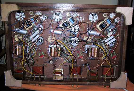

Bas,
Something I spot on your second pic intrigues me.
On that pic I see what I reckon are the bypass caps for the elco's.
(somewhere in the middle of the chassis)
Did you wrap copperfoil around them or am I wrong?
If so,what for?
Regards,🙂
Hi Frank,
It is indeed copper foil..I read an interesting article on the site of Aiken amps saying that the outer foil of a capacitor should be connected to the lower potential (earth)...providing EMI protection.
Because nobody could tell me where the outer foil was on the Audyn caps...I wrapped copper foil around it and connected that to earth.
The copper foil is by 3m and provides shielding effectiveness (far field) is in the range of 60dB to 80dB (30 MHz to 1 GHz).
Funny thing is....i don't know how much is really helps in my application...but I just did it anyway...
It is also used as electrostatic shielding between transformer windings.

Hello Bas,
A quote from that article:
"Proper orientation of the capacitors will make the amplifier much less susceptible to outside noise, including hum, interference from fluorescent lighting, and tendency towards oscillations or frequency-response peaks and dips due to unwanted feedback from nearby signals within the amplifier."
Assuming the Audyn caps are constucted the same way as most other axial filmcaps the earthing point should be constistently at the input,i.e. the A of Audyn.
I stress that that is where it should be,field tests will show that not all manufacturers bother.
If you would peel away the plastic foil with brandname and specs
you may have found that band.
Sometimes you can actually feel it without peeling away anything.
If you have the necessary test equipment to run the test as described by Aiken it would surely tell the tale.
Building as they describe will provide a bit of extra immunity to RF
and EMI induced garbage.
Especially true in case of your design since it's in virtual "cabrio" mode.
That copper tape is relatively expensive too,isn't it?
Give it a try if you like.
