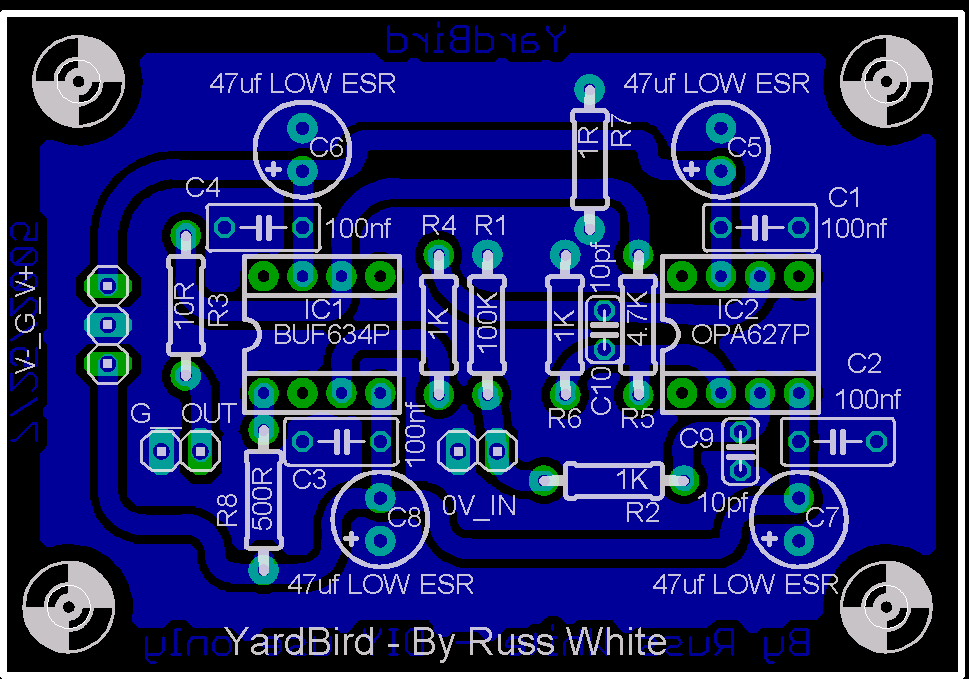

The reason is that you can apply the bias to the buf634, which has an impact on the FB loop to the 627/637. 🙂 No need to apply more bias, though it would be very easy to do so, simple put a resistor between the negative rail and the output of the opamp. 🙂
