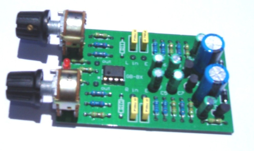

Here's my new little (3" x 2") Bass Extender. It's a tunable Q=2 high pass filter that runs from a Plug-pak (Wall-wart) or can be wired into a PS feed of +/-18 to 25V.
It gives a 6dB boost at a tunable frequency from 20Hz to 50Hz to restore the 6dB down bass end of a speaker to 0dB and then rolling off at 15dB /octave to be 40dB down at 0.1fo. The response is wideband from cutoff to MHz and gain is unity or up to 8dB. It's stereo with a fully ground planed board and discrete 2BJT low noise 80dB regulators supplying the dual FET cascode op-amp chip.
LF extension can be almost an octave of cleaner bass with out of band LF modulation reduced dramatically resulting in better power handling and lower distortion. It takes care of unloading.

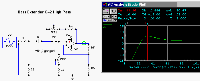

Hi Kanwar,
Here it is. VR1,2 are a dual ganged pot to tune from 20Hz to 50Hz for the peak to restore the -6 dB response of a speaker back to flat. Since the -6dB standard speaker is well capable of output but less capable at lower frequencies, there is definite and considerable audible benefit in boosting this narrow band while filtering out the subsonics that are well outside the speaker design range and where the often unloaded cone movement causes distortion due to infrasonic modulation causing extreme movement from the linear range of the motor magnetic field.

I built myself something similar. My subwoofer is a 6th order system. Of course my perfboard project isn't nearly as pretty as Guru's.
Since I knew the woofer's response, I was able to fix the frequency and make the Q variable over a range of .5 to around 3. Anechoically my woofers need a Q of 2 at 20 Hz, but in room it is somewhat less. With a twist of a knob I can go from smooth response for music to kaboom for HT. Too bad pots to vary the Q wouldn't fit guru's form factor.

Bob, if it's used with a sealed box (-12dB/octave) it's 4th order. With a bass reflex (-24dB/octave) it's 6th order. Sure, a parametric would be cool but complex and I wanted to keep it simple - with only one op amp in the signal path. minimalist.
I produced one of these 12 years ago as an addend to some double bass reflex systems taking them from 40Hz down to 28Hz really restoring the SLAM of the live performance. The other really beneficial application was for compact and bookshelf systems at the upper limit - just amazing how much bigger the bass was, without needing to resort to a sub.

Hi Bob,
Yes I see that's possible - so I guess R5,R6 could be hardwired as a front panel pot. Gain, of course would be all over the place though as these two resistors set the op-amp gain at 2.5 and the input divider cuts the signal back accordingly for zero overall gain in the pass band. If it's in a tape loop for instance, it can be switched in and out without level shift - only the bass extension.
Of course you could make the input divider a volume pot and add your suggestion for Q varying - and there'd be no shortage of controls to play with!!

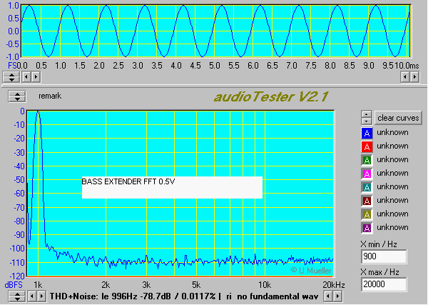

Thanks for the constructive comments. I'ver done the bass response earlier I was looking at the wideband performance as it has the full audio frequency range to not impose on.
Ah..You noticed the 870Hz +735dB spurious peak in the response. Guess you don't wantr one then?
Seriously it's a piece of cr...rubbish on the measuring system. Ask Mr Mueller. It ain't there when I change range.
Greg

Well Hi djk,
...."Be careful of the gain in the opamp. If it is too much higher it will oscillate"...
the dual op amp used is an 8MHz UGS (unity gain stable), 20V/us
FET cascode input type running at closed loop gain of 2.5.
Please enlighten me as to how it is on the verge of oscillation?
Bob, you must surely appreciate the value of a high pass filter to ensure cone control as does Kanwar (from another thread) making for better power handling and lower bass distortion.

Hi odysseybmx414,
The values are pretty straightforward. Let's see -
VR1,2 DG 50K
C1,2 100n
R3,4 27K define the range with the pots 27K->77K
R5 3K or 3K3 gain of filter and peaking
R6 2K
R1, R2 divider to restore unity gain or 8dB without. Add to >10K, for input loading.
Of course a considerable part of the design is the 80dB discrete regs and the progressive layout for reduced interactions through hole plated, ground planed and double side solder masked PCBs available through my website. A poor layout or common ground tracks could result in a reduced image, resolution.
