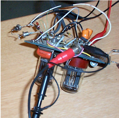

At one time I decided to build a prototyping system, since I have many ideas, and only a few of them actually work. The first generation was nothing more than tube sockets screwed down to a piece of wood. Interconnection was made using Radio Shack clip leads.
The second generation was built in a wooden box, with a cover (which I never used). The wood base was covered with a layer of copper screen which was tied to circuit ground and earth ground. Each "module" was a circuit board with one or two tube sockets on it. The tube sockets were wired to Fahnestock clips (available from Mouser), so that interconnection was made with insulated wire or the component leads themselves. I still wound up using clip leads for some interconnection.
There are pictures of it here:
http://www.tubelab.com/The_Tubelab.htm
This thing is big, almost three feet wide. It takes up too much of my bench space, so I am building a new one. Same basic idea as before, but the modules are smaller. The modules are similar to these, except that I put the tube sockets on the other side of the board:
http://www.iagaudio.com/products.asp?id=3
I still use the Radio Shack clip leads for interconnection and have not had any problems. They will melt if they touch a hot tube however. I made some of my own for use on high voltage circuits, and for use around hot tubes. I used Teflon wire, it doesn't melt.
I prefer this type of open prototyping system because it allows for quick circuit changes. It is however inherently dangerous, and safe operating procedures must be used around it. I will connect all meters, scope probes, and signal sources up to the circuit before applying power. I stand a safe distance away while the circuit is live. I will always have the circuit "doubly disabled" when working on it. This means power strip off AND power supply unplugged. This makes it impossible to accidentally power up.
If you don't like the open arangement, mount the individual modules on the under side of a piece of thin wood or metal such that the tubes protrude through holes in it. Then mount the whole thing on some type of enclosure using hinges. All wiring and components are under the lid, which is opened up for circuit modification. You could even add an interlock to disable power when opened.

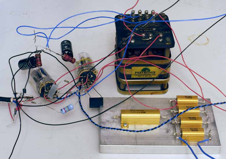

Is this scary enough? It was a 5W amplifier that wasn't terribly good. So it's just as well it didn't take long to make.
SY said:
A constant current diff amp.
Yeah! Those are the kind of scary things I was hoping to avoid!😀
It looks like I'm not risking my life using RS clip leads so I'll probably get a couple more sets. And I did start looking for an adjustable power supply (like the Knight on Tubelab's site) to handle PS chores.
Sherman said:
It looks like I'm not risking my life using RS clip leads...
Yes, you are. The thing about those horrible lash-ups is that they were built and tested in full knowledge of their danger. I am extremely nervous about electricity. It's nasty stuff, and it kills. When I knock up something as dodgy as that I surround it with test equipment and don't go near it when it has power. I wind up the HT very carefully and monitor both the HT current and voltage as I do so. I shut everything down at the slightest hint of an irregularity.

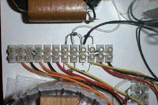

I've made several different phono stages and a couple different line stages in the past few years and I didn't want to entirely rebuild everything each time so here's what I did. There are small (about 4 x 6") steel plates available at Home Depot in the timber framing section and I bought several of these over time. I have a partial chassis that contains some terminal strips (screw-type) which connect to the umbilical cord to the power supply I built for these projects. The partial chassis is like a shadow box or deep picture frame, it is basically an aluminum box with no top and about 3" deep.
When I build a new circuit module I just have to punch holes for the sockets and attach a few lug-type terminal strips in one of the plates. The "frame" has some screws that hold down the edges of the plates and so the whole thing is both well-enclosed and also easy to monkey around with. I add some wiring with spade lugs to connect to the screw terminals for B+, ground & filament connections.
This has been pretty flexible and has worked well so far. But it is kind of ugly.
Here's a photo. In the photo, the front plate is an Aikido line stage using 6SN7's and the rear plate is one of my 6C45P phono stages, I'm not sure which one:
-j

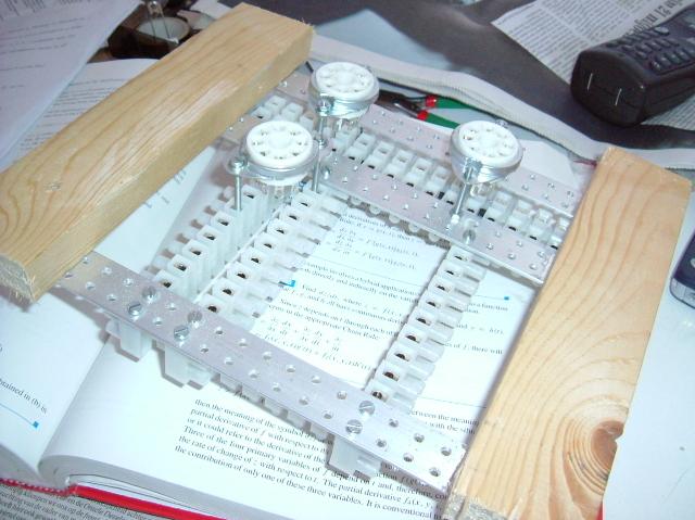

I use anything from boards to bread pans.
Lately I have been using these term strips from Radio Shack. They can be easily cut and screwed to a board, were needed and used in place of solder points.
I love the tube lab idea! I bet a combination of the Fanstock clips and these would work great.
