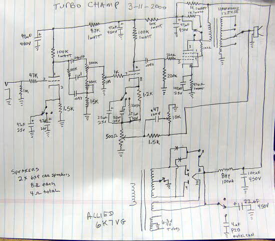

I am updating a Fender Champ. It used a 12ax7 to drive a 6V6 tube. Will the 12ax7 drive a 6L6GC tube adequately? Or a 6550? Or is a buffer (cathode follower) required?
Thanx all!

Yes I am updating my old Champ amp. The output transformer is now from a deluxe reverb reissue, the output transformer is now a hammond 125ESE. I plan to try 6V6, 6L6, 6550, or KT 90 in the output stage, no cathode bias. The bias tap created a -50 VDC bias voltage which feeds a 25K pot to either a 220K or 100K resistor. That's why I asked is a 12AX7 could drive all tubes, perhaps a second 12AX7 stage in parallel...I have the room. Thanx all!
I found the schematic to my "Turbo Champ". This may not be of much use to you if you have already made your plans, but you may find an idea or two to steal. I built a few of these over a two year period. Each one was slightly different from this schematic, mostly value changes in the tone stack and the feedback circuit.
I have used several different speaker setups. The amp is most flexible with a 4 ohm speaker, but an 8 ohm will work. The first amps used a 6 inch Champ replacement speaker. The later amps used a pair of car audio speakers either 5X7 inch of 6X9 inch.
If you build one there are two important things to remember. Never operate the seaker impedance switch with the amp on. Put it in standby mode.
The power supply has three cap settings and two rectifier settings. Some combinations can produce more voltage than some tubes can handle.
This amp can use a wide variety of tube, but you must think before you randomly flip switches.
I will post a clearer version of this picture on the web site,in the next few days.
