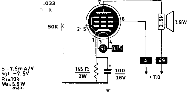

I found this schematic online here, and I have a 50c5 and a few other tubes laying around.
does this look right? I'm not sure this is the whole circuit.... Anyways Id like to throw one together on my protoboard tonight or tomarrow. I'm gonna use a 12vac wall wart and run it through a 12 volt transformer to step up the voltage again. Tranny doesnt have to be too big as this tube only requiers a few ma of current I assume.

The first circuit looks OK. For some really dirt cheap record players made back in the "day", the amp used was just like that. However, don't expect any performance that you can write home about. The output iron was highly inadequate, and running 50C5s with those voltages resulted in some nasty nonlinearity.
As for the second
there's a helluva lot wrong with it. First off, that PS is especially bad. Connect that thing to make the "ground" 120V hot will likely ruin whatever you connect to it, and/or could electrocute you. They did that in the bad ol' days to keep manufacturing costs down. (And quite a few guitar players had some shocking experiences
with those cheap "practice" guitar amps.) They might have gotten away with it for radios and TVs where the only thing the end user would be expected to connect is an antenna. You need to redesign that with a proper PS xfmr.
Secondly, three watts out of a 50C5 is dreamin'. That won't happen unless you bust the specs and then they certainly won't last too long.

Here was the premisis for the project, I only need some simple info. I just wanted to take my 50c5 and 14gt8 laying around and throw it together on the breadboard for fun. I also have a similar 35c5 and 12at7, but I don't like the 35c5's sound as much. I may order another 50c5 later, but right now I just want to see what stinky low power amp I can come up with using my 50c5 and 14gt8.
anatech: I see how having two 50c5's and a twin triode would get my voltage right. However, I would like to keep the plate current as low as possable to be safe. For right now I will be running the 50c5 and 14gt8 off of seperate power supplies. 🙂
I'm glad the heater only needs 150ma of current, that should keep the power supply size down when I do build one.
Ok I have a question : Do I need the 14gt8 behind the 50c5 to drive it or can I run a line out directly into the input of the 50c5 (capacitor coupled) ?
Does the first picture I posted include all the parts I need JUST to make the amplifier section, or do I need to follow the other guys circuit?

Hi ThSpeakerDude88,
Just the 50C5 might have enough gain from line out. Just couple it with a capacitor to the grid. You will want a volume control. So the first diagram. You may need to fiddle with this resistor value to get the proper operating point. Your final decision will be made with new tubes.
Your 7 V bias is not negative. Measure the cathode of the 50C5, it should be positive wrt ground. The grid is therefore negative this reading wrt the cathode. Cathode bias.

Hi, thankyou for your reply. Well for now I don't need volume controll, I'll just be testing with my cd player and I can use it for vc.
I know how to wire up a pot for volume controll, but I need to know where is ground in this circuit? Is it the line between the 500kohm resistor and the 145 ohm resistor, the big fat black line ( first picture) ?
I assume the two lines with the 110v + under them go to + of the bridge rectifier.

Hi ThSpeakerDude88,
Yes, that's the common ground. The negative of the supply goes there too. Start with a higher value for the 145 ohm resistor, try 330 ohms first (erring on the side of non glowing plate).
-Chris
-Chris
allright. What wattage resistor do I need? I beleieve in my radio it uses a 5 watt 150 ohm resistor (thats for a 35c5) but could the wattage be due to the fact that it has more current running through it in the radio?
Well, you can try that one, since you have it. The voltage across the resistor will tell you what the plate is dissipating. That's just V/150 X the voltage across the tube from cathode to plate.
7V across a 150 ohm resistor gives you about 0.33W, I would use a 2W resistor there since the area is hot as well. You could safely use a 1W unit. You may find the tube needs a higher value of cathode resistor to lower the current. I would only know by putting it together. There are other members who could probably figure out the correct value in their head. That would not be me.

hey thanks! I was wondering why that 500k ohm ( or less, its 330k in my other schematic) is there.
I have my amp up and running! 😀 my first tube amp ! Its surprisingly loud, although you have to turn down the bass a bit to get any volume.The bass is great and full at low volumes, but it distorts as turned up (expected with such low output). My cd players output wasn't hot enough for the tube, so I ran my cd player into my onkyo tx-1500 and used the headphone output so I could controll bass/treble/volume that way. All in all, it doesn't sound too bad at all, and is much clearer than my old radios.
I am using a 160 ohm resistor and a 47uf cap, I will try yours out. I also added a 330uf 200v cap between B+ and ground and that got rid of absolutly all hum. Now I need a better x-fmr. Mines just a ratty-tatty one from an old radio. I'll try the one from our old rca 5t, it had a 42 output stage so the transformer's much bigger.

Hi ThSpeakerDude88,
The 1/4 W doesn't get warm might mean the 50C5 is worn out. What's the voltage across the resistor?
Your plate voltage will be fine, the 35C5 should work with the proper heater voltage. Both tubes are close enough. Your plate voltages are the supply less whatever is dropped across the output transformer.
