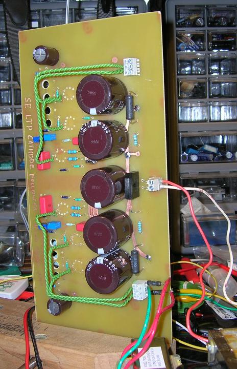

I've been lurking in the tube area for a while, and I've started a project loosely based on this http://headwize.com/projects/showfile.php?file=ahammer2_prj.htm
But I've changed the output tubes to 2-5687 med mu dual triodes to increase output current for my 64 ohm HD 570's. I've also added pots to adjust output bias and neg feedback to the grounded grid in the LTP (I can't help it, I cut my teeth on SS. I can turn it down to zero if I don't like it)
The question is.... How conservative are the plate dissapation ratings. If I'm running class A, do I need to derate things 50% like with transistors or can I safely run a tube that's rated 4.2w each section, 7.5W total for both sections at 3.5W per sec, 7W total in class A continuous and expect 5000 hrs out of a tube, or what would you say is a safe continuous dissapation. I'de rather not learn by burning up $50 worth of tubes 3 or 4 times.
I've also bought a couple of 833 's I hope to make a big *** SET out of, but I thought I should try something a little more forgiving and less costly for my first glass amp.
I'll take some pics of the board I etched last night and post after I hear some music. The tubes should be on the front porch when I get home this evening, and I may get to fire it up tonight.

If you don't exceeed other maximums, you can indeed run the tubes full throttle. But that means not exceeding maximum current, voltage, or (very important!) bulb temperature. The last is often a problem in tight constructions with no forced air cooling.
Thanks SY That's the answer I was hoping for. It's going to be in the open proudly displaying itself, so temp shouldn't be a problem.

I got the pattern size way off on my tube sockets, Now i'll have to cheeze one on with pigtails. I knew I should have waited for the sockets before I did the board. I considered soldering the tubes straight to the board, but that would really be bad form.

I was about to put power to the thing, and I was looking it all over and noticed that my paralleled resistors that should add up to 500 ohms were 7 @ 75 ohms each. I devided 500 by 7 instead of x 7. Now Ace electronics is closed and I'm stuck reading instead of adjusting and listening. Don't you hate that.
If you need 500 ohms, and you have 7 75 ohm resistors, put them all in series. You will get 525 ohms, which is likely close enough.
You read my mind. That's what I did, but it took some riggin. Sine looks nice on the scope. I like to test XY with the probes on input and output and look at the line as i raise the frequency. You can see phase error as a opening of the line when you get near the upper bandwith, and I had a perfect line up to 200khz, so I can use the neg feedback to lower output imp if needed. I'm only getting 150 mW RMS due to current starving the neg swing, so I may go to a larger than 500 ohm resistor and bias to get a lot more voltage across it and balance the current swings more to the ground without getting too close to the edge of the plate dissapation limit.
Or maybe get the other channel up and listen for a while first.
But my first tube project lives.

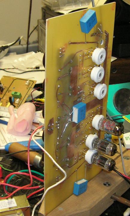

I got the second channel up, balanced the gains, dropped the bias to a safe level, and plugged in the CD player. The second channel only has 2.5x gain, so I had to put a 2 dB of NFB on the first.
The cymbals are a little harsh, but I presently have **** electrolytics bypassed with **** MKT from the surplus store untill my big Solens get here. But even that seems to be easing as I type. The CDP is also semi **** Yamaha DVDSACDHDCD. I'm quite impressed. This tube stuff is too easy. I've never had a sand project work well right out of the hole like this.
It's almost good enough to slap it in a box and call it done.
Here's a pic
Here's a pic
