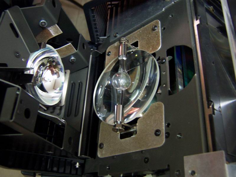

In my case I try a double endend 150W MH lamp. I use it just for a couple of minutes and it seems to work. To do it well you may need to replace the spherical reflector to one wich focus matches the center of your lamp (the right thing would be to change de condenser lens too...but in my case I don´t have a condenser, just a borosilicate glass). While doing it, the new reflector lens surely won´t fit in the original case, so you fill find to modify it too.
If you can get the lamp that uses YWH maybe you won´t need to make any case mod, as it seems to be much smaller than a common 150W MH one.

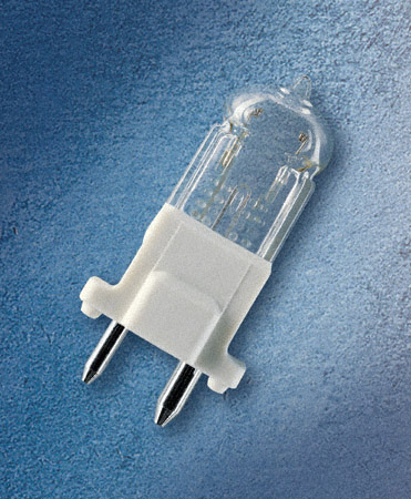

Spode said:What's a UHP lamp?
The halogen lamp in our case has its advantage over the ones you can see at others commercial projectors. It cost less than U$S10 (here in Argentina), while the others, the cheapest ones are always above U$S200! In the case of old models here in Argentina about U$S600 (400 outside)
In this kind of lamp, about 20% of its 400W goes to light, the other 80% finishes as heat
If you use a discharge lamp like a metal halide one, 80% goes to ligh and only 20% to heat (aprox.). Thats why the natural change will be to replace the 400W halogen with a 150W MH one.
Old projetors, like Epson ELP-3000, uses MH ones. An evolution of the MH lamp is the UHP lamp. UHP goes for Philips lamp development of this technology, another brands may use a different name (may be UHE I think). Between MH an UHP lamps are some technical diferencies like startup condition, frecuency that they run (UHP may work with CC while MH only with AC). But the most important difference is the arc gap lenght, as smaller is better, UHP has smaller arcs (point light source).

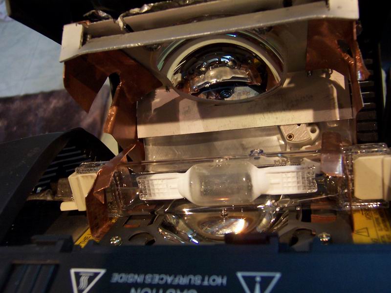

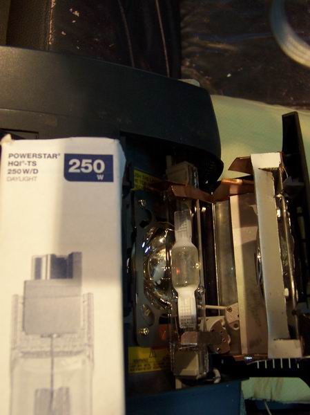

That´s what I try, the double ended 150W lamp and I also give up.
But this lamp has UV stop, implemented in the outer glass. Does the lamp you are using has UV stop?.
In three panels LCD models the UV filter is commonly implemented throught the light engine, so using you lamp or one like the HTI 150W/HTI 152W wouldn´t be a problem. I discarded the HTI because it doesn´t have the UV filter.
The CTX as it is intended for an halogen one doesn´t have any UV filters. I saw the condenser lens for the CTX 580 (MH lamp) and it appears to have the UV filter in it.

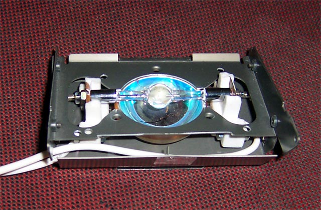

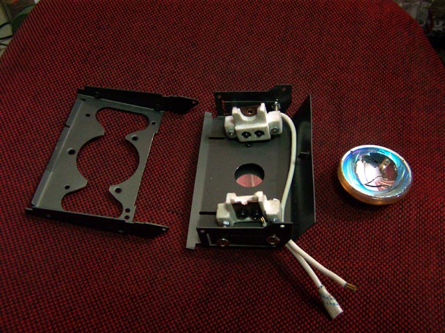

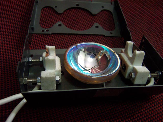

ywh why dont u tell us how we can convert these things. you are a expert why not help weaklings like me??
hi!

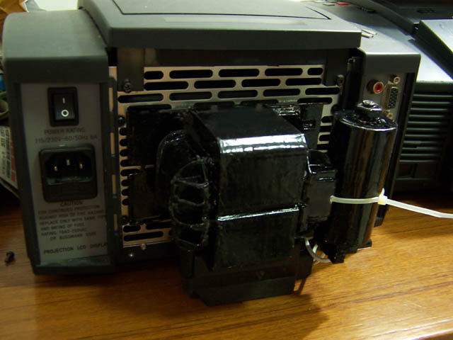

I sent the pictures, step by step to convert these things.
new holder, new lamp, new ballast, if you have a CTX, all of things is easy.
what do you need ?
what do you need ?
