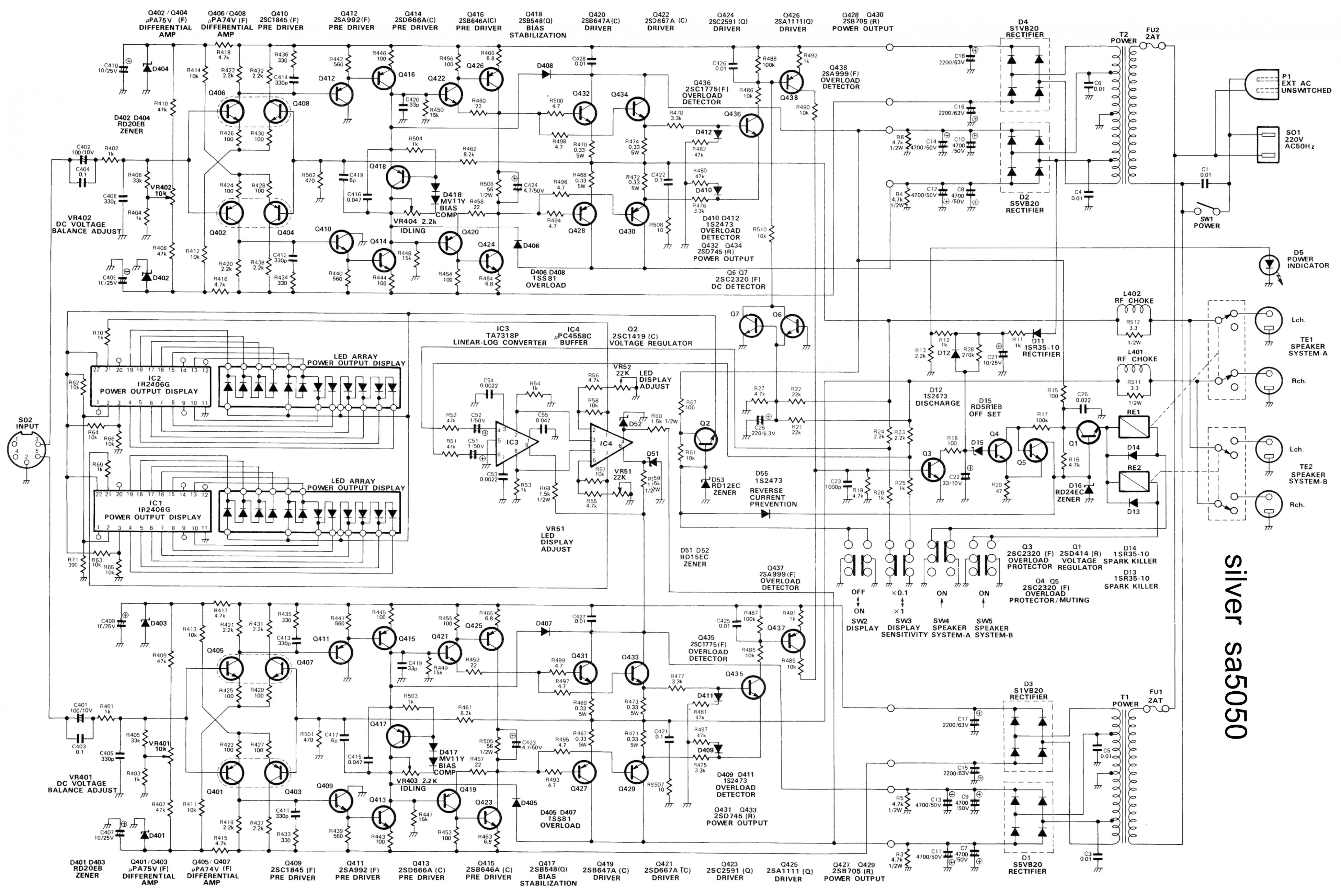

power amp
manufacturer Shin Shirasuna Electric Corp.
model Silver SA5050
dual mono (even two potted toroids) independent PCBs for each channel,with two pairs of 2SD745 and 2SB705 in each channel as outputs
predriver and driver stage (don't know,maybe is even cascode in case?-didn't checked yet) awfully hot -with 2SC2591 and 2SA111 and few little ones on little mutual heatsink,mounted on child boards,one childboard per channel
2x40 for output stage and 2x46 for driver and input child board
my guess is that this amp is from Otala's days in mentioned company;
Google didn't help to find any further info
somebody knows anything more?

silly me 😀
it's a Harman/Kardon HK-770 and 720 ,with DIN inputs and outputs,for German market
I'm googlin' right now-any further info or experience from someone?
http://czsr_bac.on.neobee.net/hk770.gif
230KB pic
comments?
off course-shifting it ,for start , on some 1A Iq.......
230KB pic
comments?
