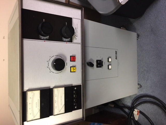

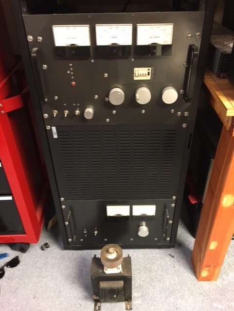

Wow! Sounds like some wild times. I've been known to give the truckers a hard time. I think I may give solid state a try in the future. I've got an HP 48VDC 3kw SMPS to power it. Some folks on a popular auction site sell boards ready to go less the hybrid modules and heat sinks. Filters are mandatory also. Here is a photo of the amp I built that contains the 120V primary transformer I mentioned. The 220V primary transformer going in it with a triode it uses is in there too. Next photo is my go to Henry amp that was converted to the same triode before I got it. I put a much beefier Peter Dahl transformer in it. Upgraded the power supply and blower among other things. Last photo is one row of radios including a 1966 Drake set. I've also got some Collins stuff including a 50's AM station. Most of the HF bands have been dead hence me dabbling in the tube audio stuff.
