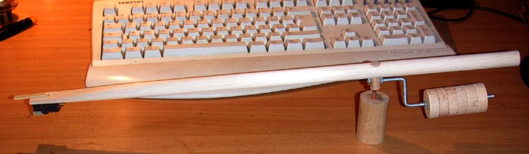

Funny ideas: it is very much "bricolage", but why not, doing first steps in dyi tonearms or TT?
This thread lighted some fire inside my brain...
The last days, I played a lot with different tubes: rolled out of balsa, different diameters. Massive wood, from relatively soft to hard. Aluminium, carbon fibre.
I was searching for a very low resonance for a tonearm about 35cm length. I took the tubes, added 10g lead at one end, fixed the other end and put the whole thing in vibrations.
The best result I got was a relatively big diameter balsa tube.
So, I will play a little bit with wooden unipivots in the next weeks 😀
As a pivot I use a pencil, as I have a very good pencil sharpener.
Franz

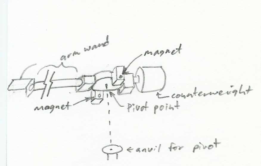

I'm working on a design for a unipivot, with two small magnets to handle azimuth, so I can use a counter weight that is level with the pivot. The pivot point will be attached to the arm as will two magnets, either side of the arm, facing each other. The centre (both side-side and up-down) of the magnets will coincide with the point of the pivot. The pivot will ride in a punch mark in the centre of a steel disk. The disk will be twice as thick as the punch mark will be deep, so the magnets will ride around the disk's equator. The arm will be free to rotate up and down over warps, side to side across the record, but not able to yaw. I suppose the magnets will also provide some damping to the arm, hopefully not too much.
I've got the design mostly worked out. I just have to plan the easiest way to machine it. All aluminum with 3/8"x .035" arm wand
Oh, and it will have a pivoting headshell, like the 47 labs tonearm.

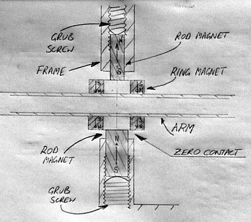

The magnets sound promising, but may not be easy to execute in practice. I assume (from thinking similar thoughts with magnets) that the steel disc will have a sharpened edge to concentrate the majority of the flux on the correct axis, and that the magnets will be thin cylindrical shapes, polarised along their axis?
I was thinking of experimenting with neodymium ring magnets and small cylindrical magnets (repelling) to see if I could successfully 'levitate' a tone arm!!!
The rings (dia 12.5mm, hole 6mm x 3mm thick) would be top and bottom of carbon rod arm (polarity aligned to concentrate flux and firmly trap arm). The cylinders or rods (dia 4mm x 10mm) would be planted in a surrounding frame, above and below the rings (both reverse polarity repelling the rings) and adjusted with grub screws to a position where the tone arm 'levitated')
Perhaps a little optimistic!
Can you post a diagram of your idea?
Yes, 0.125" diameter neodym magnets with their axes in line. I figure that like poles facing each other will be vital so as to not polarise the disk. I was thinking a rounded edge on the disk.
I don't know how much success you will have with your mag-lev idea. Magnets repel each other in a rather chaotic fashion.

Here's a crude sketch of my design. Sort of an underside perspective.
Max

Whoa, yikes! I hope that wasn't directed at me.
My suggestion of the Schroeder arm was because it seems like a similar design to what Bobhayes was thinking, only turned upside down.
If you read the Schoeder thread, it is basically just about trying to figure out how to do an exact copy of the Schroeder arm. I agree that this is not in the true spirit of DIY, and morally iffy. Despite this, Mr Schroeder himself offers his advice.
What I am proposing is a magnetic arrangement that I have not seen used in a tonearm pivot. I haven't done a patent search. But, why would I, unless I was looking to sell the design? Maybe it has been done before. I would not be surprised.
Now, the pivoting headshell, I will fully admit to copying that part from 47 Labs. It just seems like an interesting idea and one that I want to try out.
We must remember that many (most?) DIYers can't afford high end components and use duplication as a means to afford them. How many Gaincard sales has 47 labs lost from all these Gainclones being built? Probably not many. I wouldn't even consider spending that much on an amp. And, if I had that to spend, why DIY? That said, it is the DIYers who innovate and bring new ideas that keep this forum most interesting.
Max

Maxro,
I like your idea a lot, it looks relatively easy to execute compared to mine.
Would you mind at all if I was to produce a one off, of your 'intellectual property' for my own use only?
Here's a drawing of what I had in mind.
The repelling fields should (mmm) keep the arm centred, with a little play to ride the warps.
BTW, I have never seen any tonearm using magnets, and have never heard of shroeder. I thought about suspending an arm in such a manner too, with no outside influence, so if I had have built one of these devices without knowing they already existed, would I still be an 'intellectual property' thief?

bobhayes said:I like your idea a lot...
Thanks.
I agree, though you ought to do a mock up of your design as a test of the concept. I'm curious to see if it will behave predictibly.
Go right ahead. Just let me know if you go into production and we can discuss royalties.('😉')
Actually there are a bunch. Graham, Decca, Morsiani. But these all use magnets for anti-skate. The Schroeder is the only one I've seen that uses magnets to control unwanted arm movements, but its control is not directional.
If you build one like mine, just remember to place the axis of the magnets paralell to the headshell, so that the azimuth doesn't change when warp riding. Look at an S shaped (or ,properly designed, straight, gimball pivot) tonearm from above to see what I mean.

I understand about keeping the axis of rotation aligned with the headshell to maintain azimuth.
I reckon the trickiest part is guesstimating the correct size for the magnets so as to hold the arm in place, but not drag it from its mount towards one side?
Did you estimate, or calculate? (The maths must be mind boggling!!)
