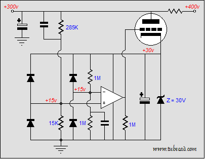

analog_sa said:
Sounds very good. Is it too much of a stretch to ask for 250-300v tube-friendly variant? What are the issues with higher voltages? Just the size of electrolytics/resistors and the minimum track clearance?
http://www.tubecad.com/2005/January/blog0031.htm
I actually think a 300V tube version is quite easy to make. I am working on a 2000VDC shunt reg using the same circuit.

take a look at the Audio Research SP-10 which uses localized HV regulators for the phono and amplification stages.
The Jung regulator is way more sophisticated than the SP-10. It would be great if it becomes available as a high quality PCB suitable for high voltage as similarly to an SP-10 i feel each stage should get it's own regulator.
I am currently using something similar with good results. Still, building 6 of these critters may become a bit tiresome.

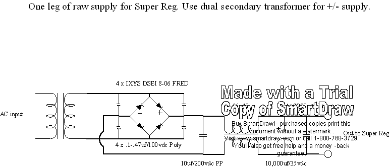

P-A,
Thanks for the reply. I checked out your website and may order from there. Have you tried Gary Galo's common mode choke in the raw supply? I usually build mine that way, with a small value (10uF) PP cap after the rectifiers, then into the CM choke, then a large electrolytic.
Mike
