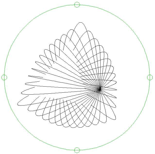

Here is the Picture
Maybe it may clerify what I was trying to say. The dark spot is directed towards one of the corners of the listening room. At a certain distance form the end point is the speaker unit. It is easier to imagine the enclosure at the corner, making 45 degrees from each edge combination.
