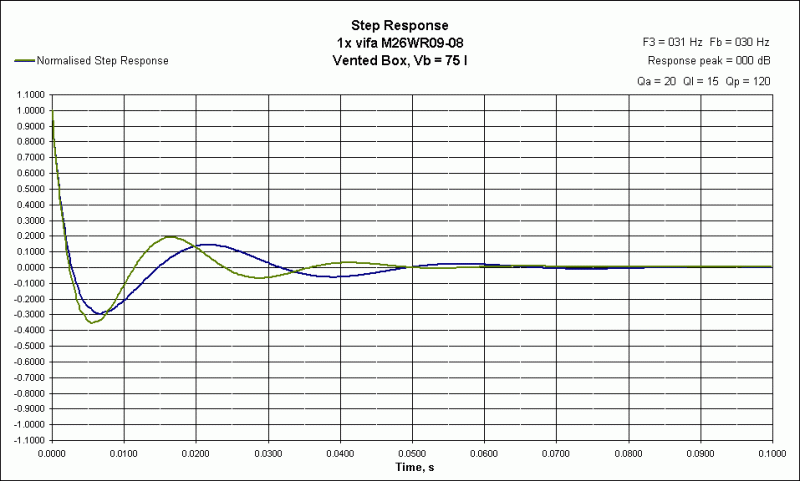

Hi TCP/IP must have missed this before, I'm just doing some modelling of my vifa 10" drivers and did a search on step response and this turned up 😉 I think that the step response graph isn't updated unless you click on the button on the graph itself!! it just stays at whatever it was before you made changes, even if you change drivers!!
below I have attached a step response graph for my vifa woofer, the blue is in the mentioned 75L box. the other colour is in a 50L box with 38Hz tuning freq, as you can see the step response on the smaller box is different.... what I'm having difficulty with is which one is better 😉 I'm leaning towards the 50L one because the decay rate is quicker, but the overshoot?? on the 75L one is less..... makes me want to go look at a TL again 😉
oh and in case you are wondering, unibox doesn't let you do comparisons like that, I photoshoped it 😉
