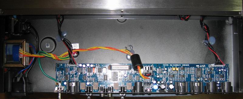

I just got a new toy...😀
Here is what you get;

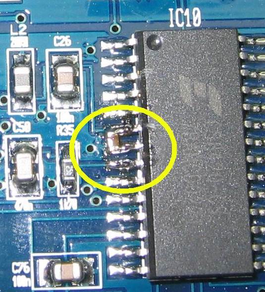

The first update
follow the *must do* from datasheet, and decouple the CS8420 on its pins: (picture)
Next; (if you will use as DAC), change op-amps, upgrade trafo/psu...

Hi all,
I had a TDA1541 DAC which is faulty Now, So I'm looking from some other DAC solutions (DIY or Tweak).
SRC2496 seems interesting despite of its "old aspect". But I can't find large PCB photos or schematic (hard to get from behringer I read).
So is there anyone who has large board picture ?
It is to verify if it could be possible (mainly space ??? ) to directly take the balanced output from the AKM4393 and add an LPF (bypassing the output stage)
I read elsewhere that the board is only layer ? Am I right too?
thanks
there's loads of space in the case .....
yes I've taken the unbalanced signal from the opamp after the dac via large pio caps ....this improves the sound lifting to a higher level. [my preamp doesn't have balanced inputs ] So I felt there was no need to run the signal through the extra stages.
