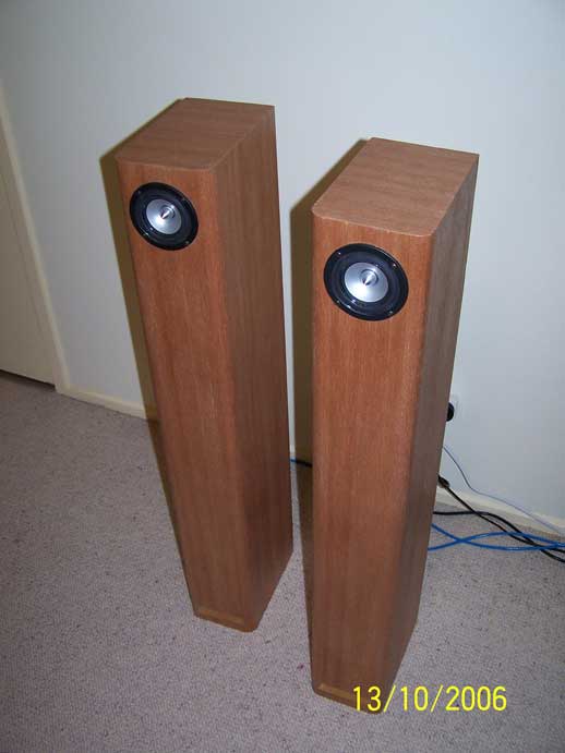

Now finally the plan in English is ready. The Stick is a double bass reflex enclosure for a single Tangband W4-655SA. The response curve is flattened with two notch filters. In room conditions it goes well down to about 50 Hz, this means Subwoofer is not a must.
In comparison to the Needles they have a better efficiency and are able to cope with higher volume levels because of about double Sd. I mean, they are still quite small chassis and you are not in danger to blow yourself out of the door (for this exercise I have constructed the "Viech" 😉 ). But in small or medium listening rooms you get really nice volume levels for such a small speaker.
I tried to get the sound as near as possible to the Needle, which I like extremely well, and I think it worked out quite well. There are small differences, the Sticks play a little bit more dynamic and analytical, the Needles a little warmer. But the difference is extremely small, I don't know if I would really pass a blind test.
Here is a picture of my pair:
Here is the plan:
Here is the frequency response without the notch filters. You can see a rather flat hill in the mids and a resonance peak at about 7000 Hz.
Here is the frequency response with both notch filters. The one consisting of only C and L filters out the peak, the other one flattens the mids. The raise in the heights is not flattened out, because it softens off-axis. So I recommend to place the speakers in parallel and not turned in.
Nice greetings, Berndt

I'm in the middle of building some of your Needles, so I was interested to compare them with your Sticks, and I came up with a whole load of questions :
The Sticks (and the top and bottom of the Needles) are specified as 16mm thick. That's not commonly available in UK. Would 18mm do, provided the internal volume was kept the same ?
What was the benefit of rounding over the baffles edges, and were you able to measure it ?
Would the speaker benefit from recessing the drivers ?
Would the Needles benefit from rounded over baffle edges and recessed drivers ?

Hi mod_sonic:
Regarding your questions:
- You can use 18mm boards without problems, as you already said, if you keep the internal dimensions the same. Take care, that also the lenght and the cross-sectional area of the ports are kept the same.
- The 16mm of the top and the foot of the needle have only optical reasons. You can replace them with 12mm or 18mm without problems.
- Rounding the baffle is always a good idea, because it makes the frequency plot under different angles more linear. Fullrange-speakers tend to beam the sound, so this issue is not so critical than with multi-way speakers. If you have the possibility to round the edges, do it, if not, leave it. Although rounded edges are better for sure, I doubt that the difference can be heard.
- Same for recessed drivers. Due to the beaming it is not so critical, but do it if you can.
- There is one tweak I recommend strongly for Needle and Stick: Bevel the inner side of the driver cut-out as described in the Stick plan. The W3-871S as well as the W4-655SA have huge magnet caps, which otherwise hamper the air flow.

I'd certainly agree with Berndt, about chamfering the internal edge of the driver opening. I've just built a pair of needles and ran them a while before veneering. I missed doing this during construction, so before applying the finishing I put a rebate on the inner edge with a rebate bit and bearing acting as a patten bit.
The sound certainly opens up and sounds less constrained; a lot easier to listen too.
