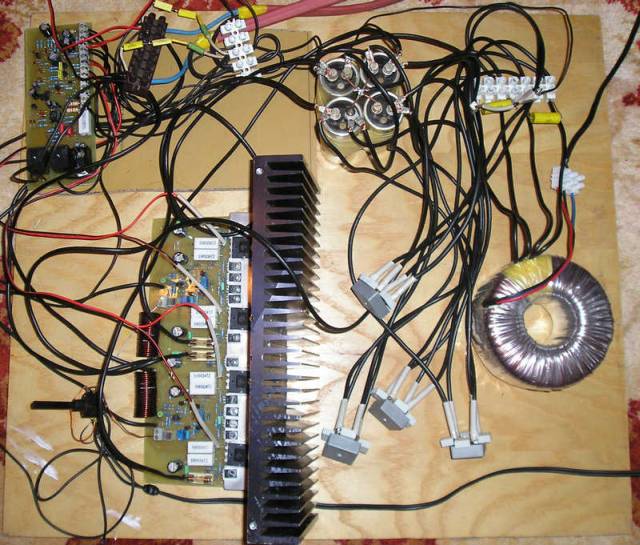

Omni protects the power transistors in case of overload, the speakers in case of power amp malfunction, protects amplifier in case of short circuit in loudspeaker or speaker cable or too low impedance of connected speakers, and also performs a muting function when the power supply is turned ON or OFF.

I would like to ask Bora what is the purpose of Q3 and Q4 in the Delta design?
Does that connection have a name(after perhaps from some inventor), I have a weak memory I have seen it somewhere.

I also have to stress that some of the simulation results (mainly THD) should be taken "with a good pinch of salt" for, practical results were in some cases more than 10 times worst.
ILIMZN - thanks for answering to "Ultima Thule" for me. As I expected, you gave correct answer with maybe little addition that it is actually linearising technique that I have learned from big master Hawksford. I hope, no one think even for a second that it is my invention! It is generally known as "linearised cross-quad". Anyone interested for more details should search for Hawksford's articles on the WEB.
