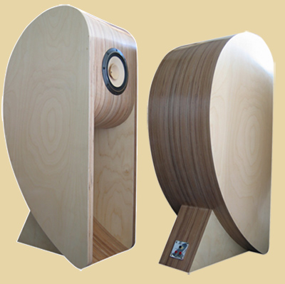

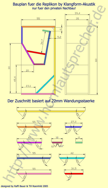

We have designed this Horn for the old Fostex Fe208Sigma. We will soon publish the complete guidance on our private page http://www.hornlautsprecher.de
Please note that we dont have any economic interests and we publish our plans only for the private use. If you have any questions feel free to ask. I hope I can answere all questions.

I was planning on building the recommended BLH for the FE208SIgma. Your's look simpler. Don't know much abou horn designing but if you could state what where your designing goals and if you have already constructed it it would be great. Thanks,

our goal was to build a good working horn for the Fe208Sigma. We wanted a loudspeaker that can play without a subwoofer and any active or passive equalasation. The sound of the recom. encl. was to boomy and the characterristic to rough. We couldend relax while listining the horn. So Raffi and I were trying out new ways and new formulas and ended at this king of horn.
After a long time we have found out that BL-horns are pretty simular to a bass-reflex. So we build couple of idea an finaly got these parameters.
After optimizing everyting our Replikon has following shape. We are selling the design version so we will not publish these plans. But the straight version is free for private use.

greetings Raffi and Till, I'm curious to know if the Replicon would work with the Fe206e and what if any mods wouild you have to do.the straight Replicon looks like quite an easy build as far as horns go but I already have the 206 drivers.keep up the good work cheers fergs
hi fergs1,
it will not work as good as with the Fe208Sigma. Raffi is trying out a version with the Fe206e. If I get any parameters I can post them here.
All I know is that the length is a bit shorter an the throat is smaller.
regards Till

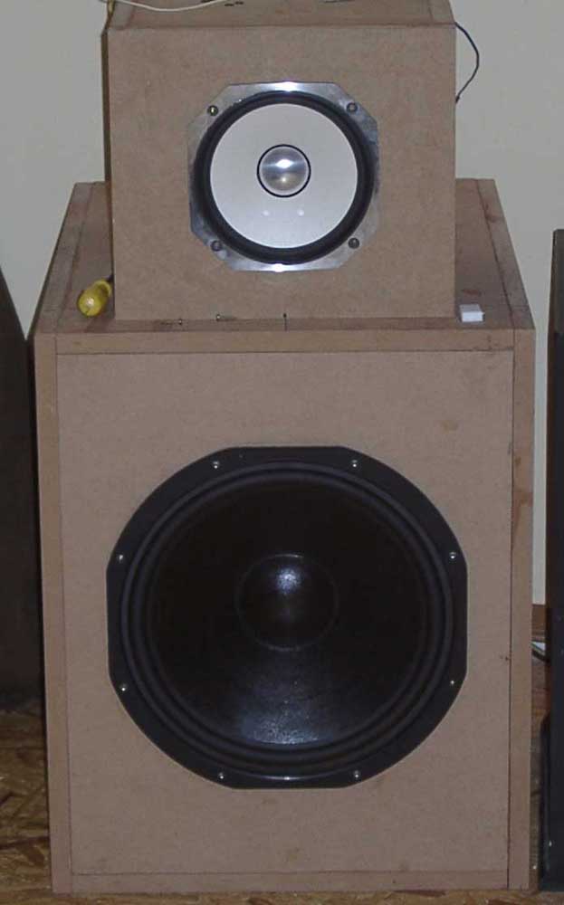

I´ve got the FX200 in a BL-Horn http://www.diyaudio.com/forums/showthread.php?s=&threadid=65061 (--> last posting at this side)
You can not compare these two horns. The FX can play deeper than the FE208Sigma in the Replikon. But you have the feeling that the Replikon plays with a bit more control. The character (?!) of the Replikon is harder and not as smooth as the FX200-horn.

One of my favorite combinations was the FX200 in 25litres closed with a VISATON TIW400 in 135 liters closed.
